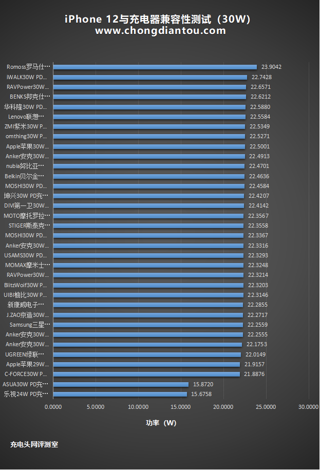

Based on a test using 34 different 30W adapters, the iPhone 12 pulls between 22-24W during charging.

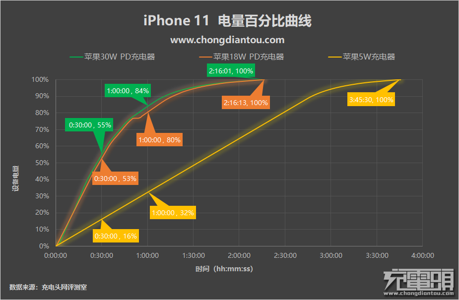

If it same as iPhone 11, power draw above 20W last for a very very short time. I think this picture explain easily how power draw evolves when charging
In short, a 30W don't damage battery ofc and you can expect a very slight speed boost just at the very beginning vs 20W but it will be very very negligeable.
If you buy a power adapter only for iPhone 12, you should probably go for 20W to have a smaller charger.
If you can take advantage of the extra 10W for other devices, then sure consider a 30W to have a more versatile power adapter.
Yes, they did the same last last year. To get the absolute fastest charging speed, get the 29/30W adapter.
the speed difference is 12 sec on 2.25 hours charge for a bigger power brick. This is not convincing.
Plus the speed difference around 1hour mark can't be a power-related issue (20W+ only during the first 20min of charge) so results will change if using an other adapter or even probably just repeat the test with same stuff
