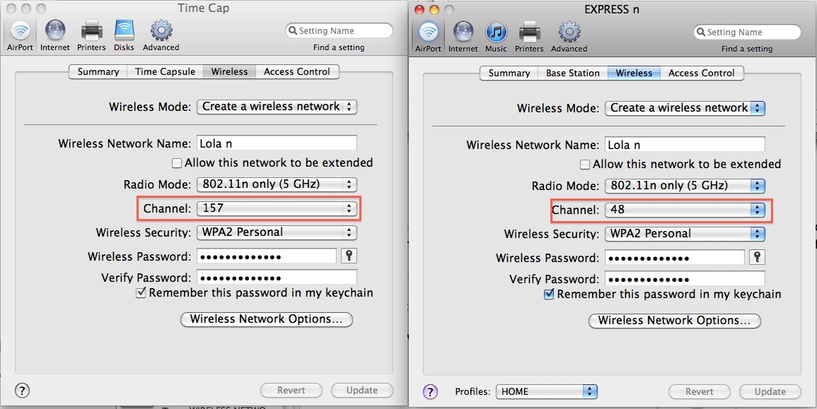

  8. laurenr, May 18, 2011
    laurenr macrumors 6502a
    laurenr
    Joined:
    Jan 9, 2008
    Location:
    California
    #8
    If you are extending the range of your wireless network via a hard-lined, ie. ethernet cable , you are in fact trying to set up a ROAMING Network, as opposed to "extending wirelessly". This is why your setup is not working. In this case, BOTH base stations must be set up to "Create a wireless Network". The primary would be set to "Share a public IP Address" and the secondary would be set to "Bridge Mode". Both setups would otherwise be identical - same Network, password, connected via "Ethernet". The only difference is in the channel selection - set each base station's channel selection as far apart as possible, (holding down the Option key will give you more choices). Do NOT check the box on either one to "Extend the Network".
    My setup:
