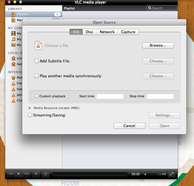

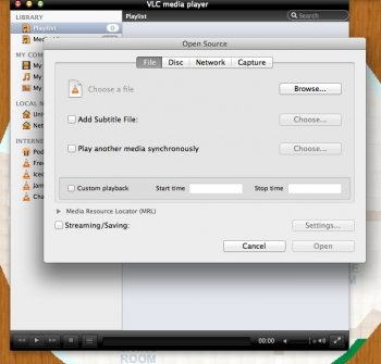

Thanks Weaselboy. It kind of worked, but the file is not opening. I get this from VLC: see attached image
If I choose the right file through that VLC window then it opens at the right volume, but I need it to open directly from iCal so it can work as an alarm... any ideas on what else could be wrong? Code looks like this:

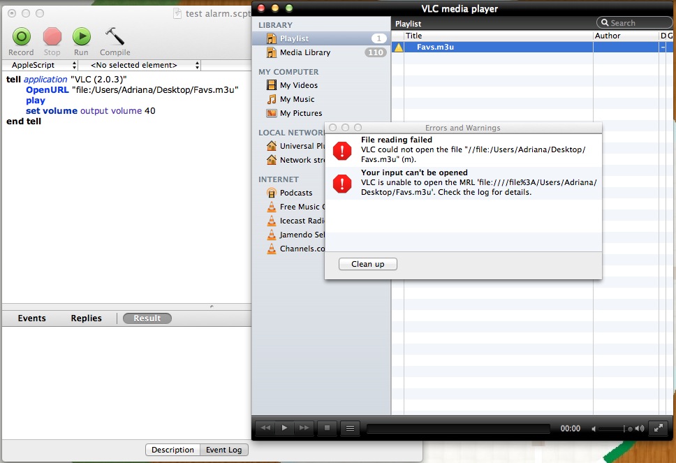

hmmm I don't get the window anymore but an error from VLC... see attached image
