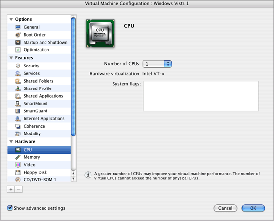

However this advertisement is telling me that we can run high-performance PC-only software at full speed in a Mac’s native hardware environment without rebooting. I have been using Paralells Desktop 5 to run Windows 7 visually on my new iMac, but my PC-only software will never run at full speed on my new iMac. I checked the perfomance on visual mode and found that Parallels Desktop allowed my iMac to use at most 1 Core or Processor (I have 2 cores) and 2GB of Ram (I have 4 GB). So it's not running at full capabilities of my Mac's hardware at all.

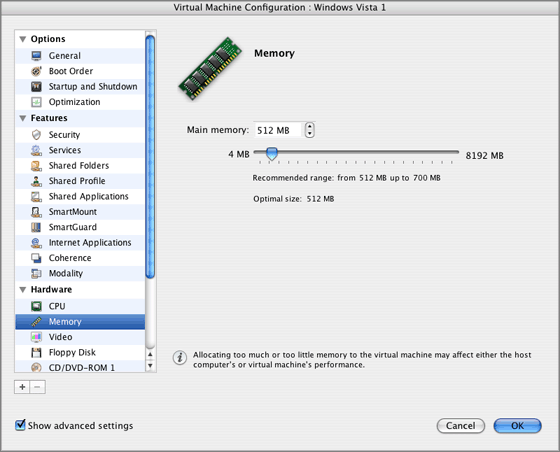

But as far as I can remember, Parallels offers to use both CPU cores and more than 2GB RAM. You have to take a look at the settings.
http://download.parallels.com/desktop/v4/docs/en/Parallels_Desktop_Users_Guide/26816.htm
http://download.parallels.com/desktop/v4/docs/en/Parallels_Desktop_Users_Guide/22626.htm

I have only 4Gm of Ram and the Parallels doesn't allow me the give the visual Windows 7 more than 2GB, if I have 8 GB I can give them more.
Don't know Why?
