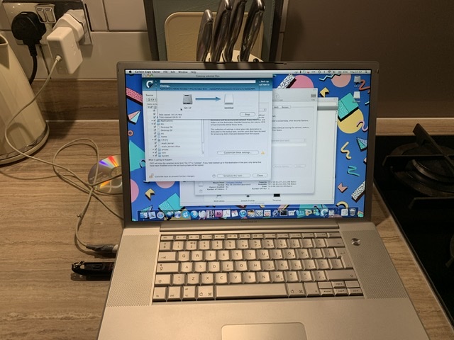

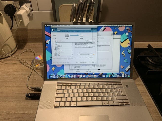

My last ditch effort for tonight is to - use an old version of CCC running on the Book itself on the old 60GB drive, cloning to a 64GB USB stick, and then I’m going to try running Disk Utility from a 10.4 DVD to restore to the newly internal 160GB drive. Have no idea if this will work, but the “joy” of cloning disks is I can leave them running while I sit down and have a G & T

So, that worked PERFECTLY! Was really quite painless too actually. I think the lesson I learnt here was don’t try to do something with software many years newer than your end destination.
in the end using CCC on Leopard to make a correct clone, and then using Disk Utility from an installer disc to restore from the USB stick to the new larger drive worked perfectly. As always, the cloning was the big time sink, the restore took hardly any time at all! I initially wanted to use my Mac Pro as I thought it would make the whole process much quicker, how wrong I was in that endeavour!
