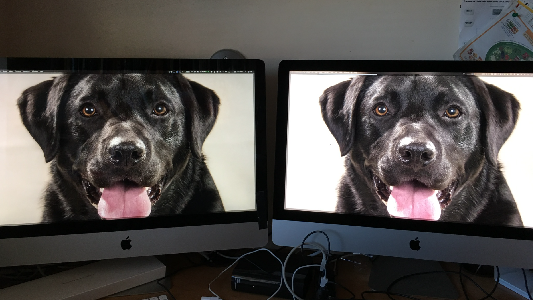

Thanks Marco -- the new one came on Thursday and it's set up nicely next to the old one, which is now a file server and second screen. It works very well, so far.
I now am permanently reminded in stereo vision that the Labrador wants feeding... The difference between the 2011 screen and the new one is obvious...
