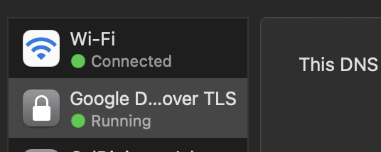

Let say I have installed a networking profile from Encrypted DNS to MacOS, so that DNS queries are encrypted.
This means I have a "networking service" in network preferences, like this:
On the other hand, occasionally I will be on a site where I need to access a local DNS server, so I want the Google DNS setting be inactive for that. I was thinking that I can set up two network locations. One is for home, and one is for work. At location "home", I have that Google DNS service active and make it inactive for location "work".
After I created two network locations, I attempt to make the Google DNS service to be "inactive" in location "work" (with "Apply"). Then i found that that service become inactive in location "home" as well. This means I don't have separate active/inactive status for that service in different locations.
Did I do something wrong, or is it the way MacOS works that I cannot get around that?
