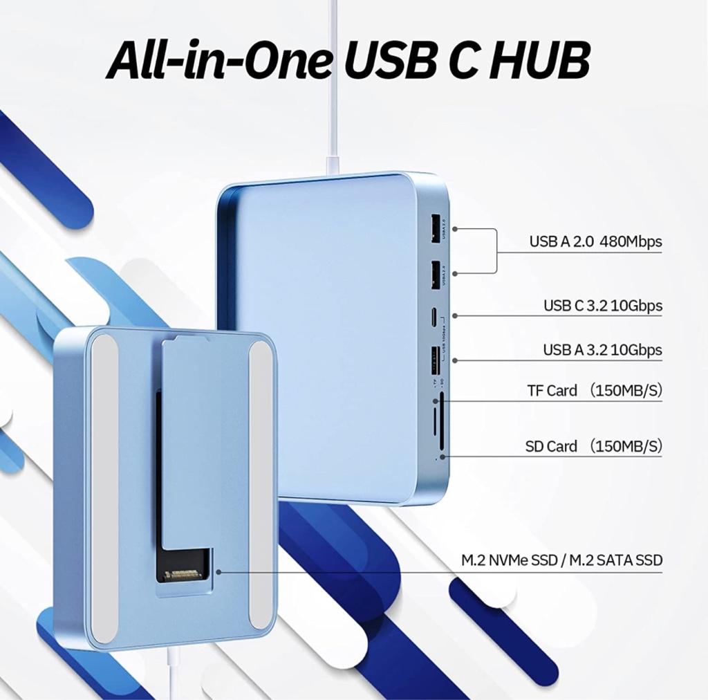

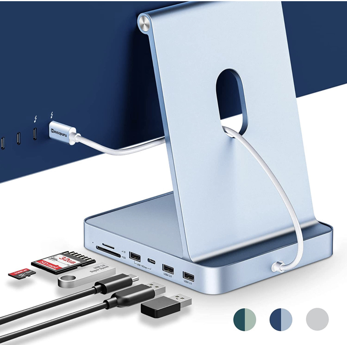

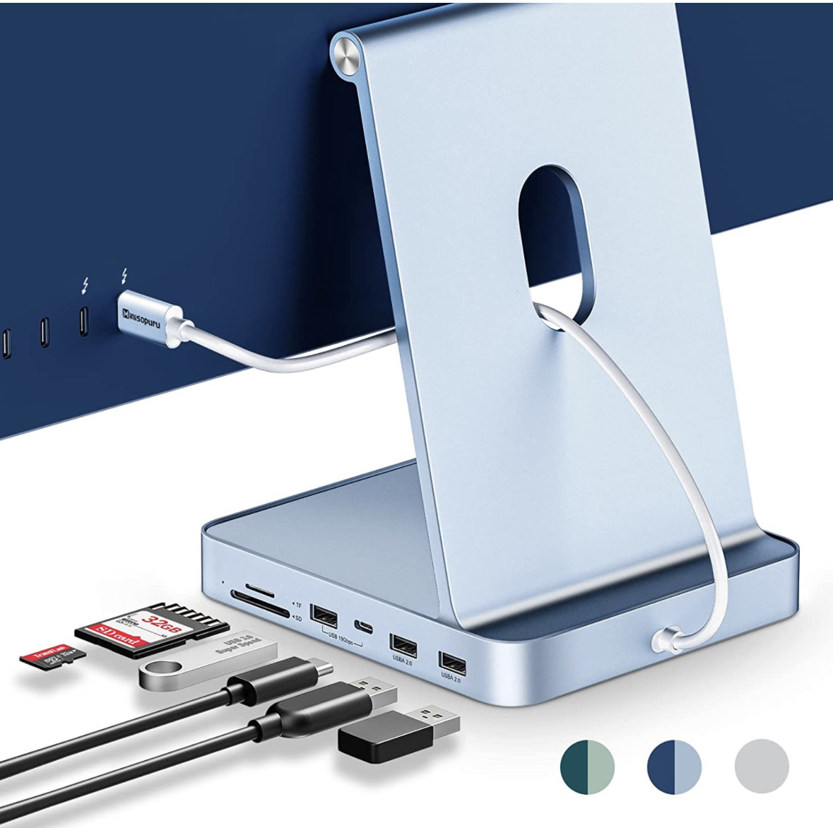

I’m looking into getting an iMac stand/dock/hub that has an integrated SSD/NVME slot in which is under the stand hidden out of way, like below.
Firstly what are these like for heat etc, is the SSD ok running in these enclosures?
Secondly would these be ok, can you even, partition somehow to have a TM and Photos library on there? At the moment I have two external, one SSD, one HDD for these. It would be nice to be able to hide it away in an enclosure and both be SSD.
Maybe can’t…just found good Apple support doc about conflicts on Photos library and TM on same external drive.
I would not recommend using products like this one, as their focus is usually on appearance over functionality. If your Time Machine is frequently utilizing a high throughput, using such a product could put your data at risk or decrease the longevity of the SSD.
So you think the SSD part is not a good idea? They don’t use a heatsink and just use a thermal pad.
Also looking at the Satechi stand/hub which just has ports on the front and no SSD slot.
Just trying to get rid of clutter, my photos library is on an external Samsung SSD T7, and TM on a older “spinny” HDD which is fine for what it does.

Enclosures made for SSDs are usually fine. I've been using one from OWC that holds both a m.2 stick AND a traditional HDD inside ONE case with a few extra thunderbolt ports for more than a year now. It gets a LOT of fairly intense use as a video editing scratch disc(s). No problems. OP, if you like the one you identify in post #1, be sure to look up reviews to confirm it is a reasonably good one. If not, shop around. There's plenty of enclosure+hub combos available.
