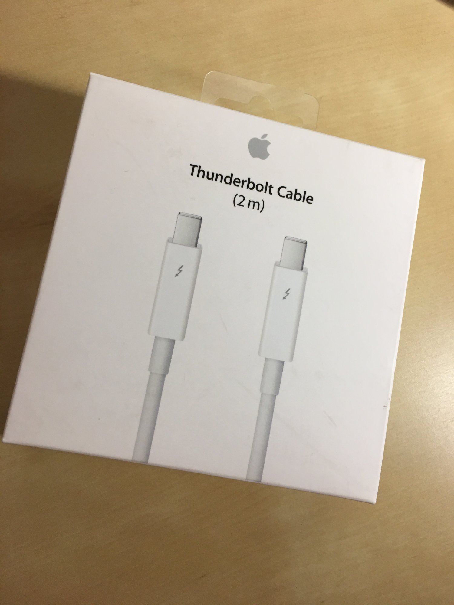

But on that point, OP, are you sure that your Thunderbolt 2 cable is actually TB 2 and not a Display Port Cable that branded itself as "compatible" with Thunderbolt ports?

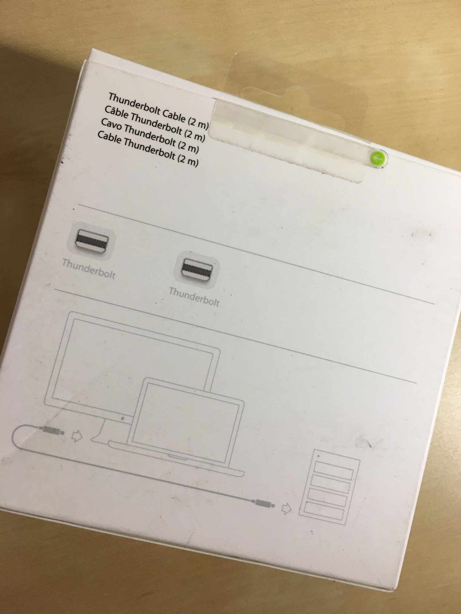

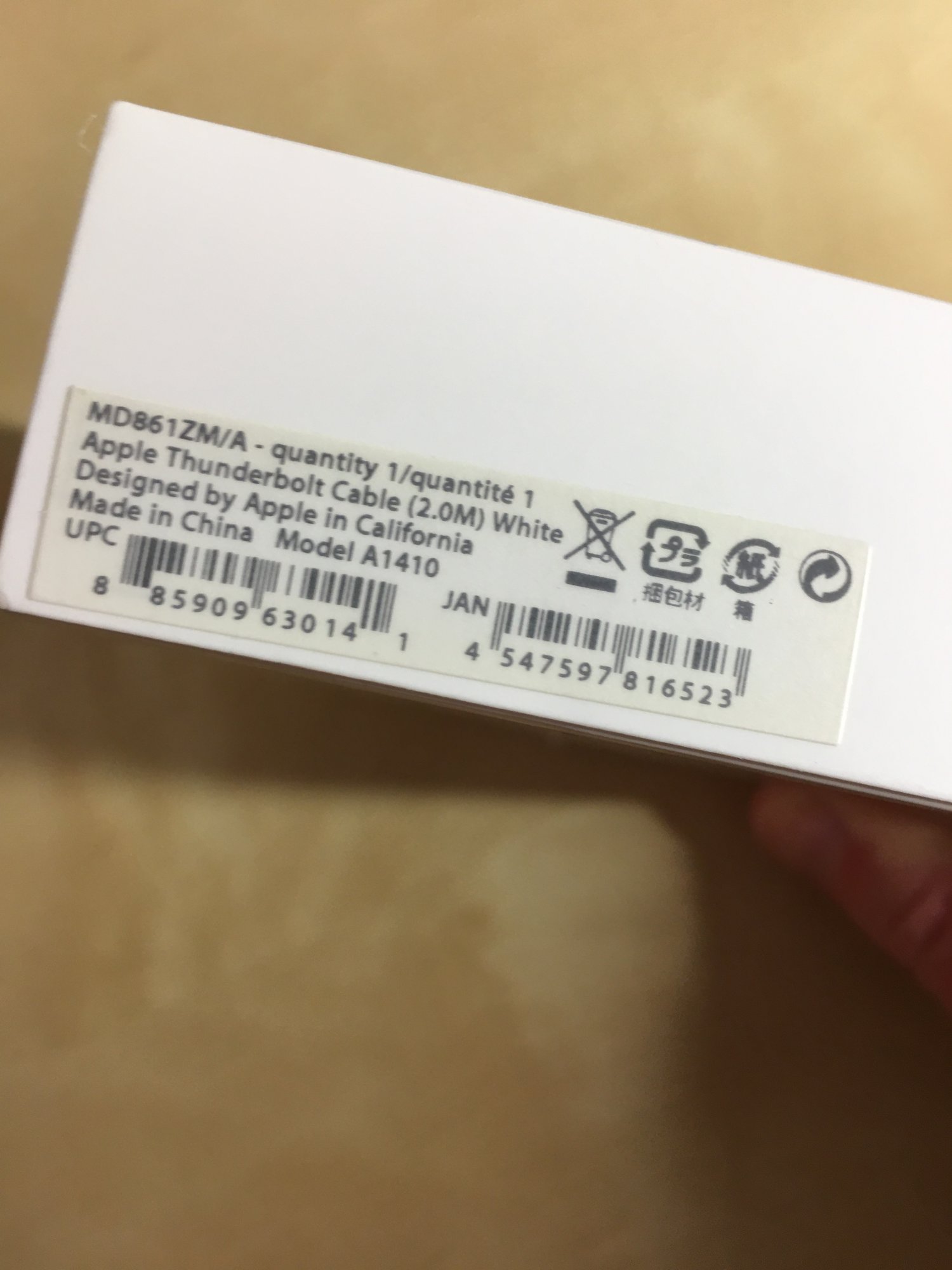

Here's some pics of the box

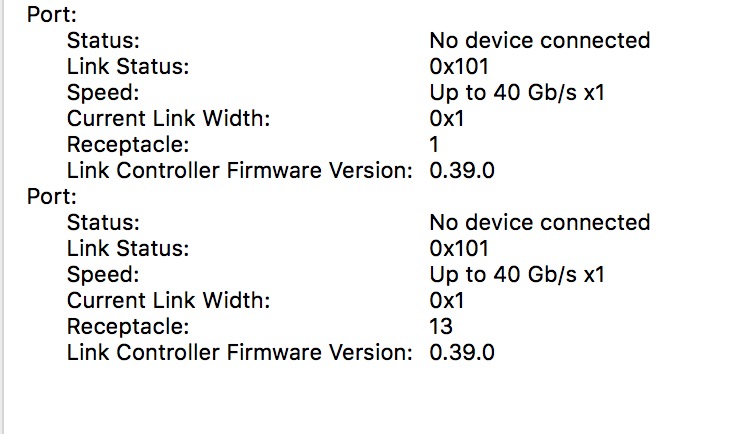

When you have it connected in TDM, is the hardware seen in System Report (you should see something plugged in under: Port Status.
Answer to this is no, it is not.

That adapter is specifically not for video use. It can be used to connect a Thunderbolt Display but standard displays cannot be connected through that adapter.
I just checked and the adapter will not show in the System Report as connected to the computer if no device is attached to it.
As mentioned, that cable should be fine (outside the rare chance of a defective cable).
Sorry...I got a few things backwards: I thought you had a TB 3 cable, not 2. TB 3 is more complicated with third party cables as to which support what...they look the same as USB C cables. Disregard this.
The fact that nothing shows connected usually means a cable/adapter/port is bad.
