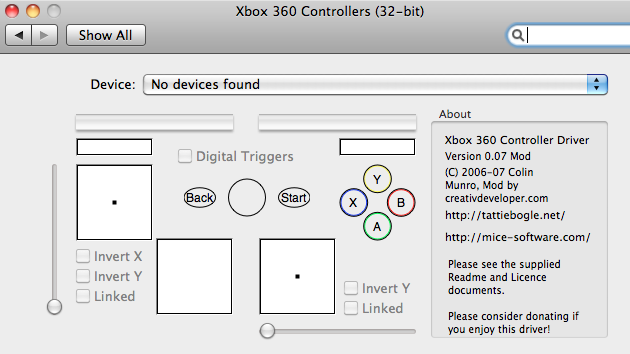

I'm trying to get this to work with my Madcatz xbox controller and i've downloaded Pref360control but it doesn't detect any devices are plugged in. Can anyone help?
I'm running it on mac snow leopard btw.
i can't seem to get my Madcatz xbox360 controller to work with this, its the only one i have thats wired. The light flashes when i first plug it in but then it says no devices found. anyone know how to fix this? i see its a reoccurring problem with some people
This is the exact same problem i have, can anyone help??
I've modified the driver to fix these problems. Grab the modded version at http://www.creativdeveloper.com/?p=103
Tested on my madcatz and hori pads, and my hori stick. I also included a setting that lets the RT and LT buttons on the madcatz and the stick function as digital buttons (linked to back and start buttons)
Source code and uninstall script also available on the site. Please support Colin, by the way!

I can't get this to work 🙁 I've installed the latest version of Tattiebogle's driver. No devices found.
-I tried using the Xbox HID Driver. Same result, no devices found.
-I tried following these instructions: http://www.creativdeveloper.com/?p=103
-I followed these instructions on YouTube: http://www.youtube.com/watch?v=IdV7WfC-mIk
-I'm using my Xbox 360 wired controller that came with my Xbox 360.
-I have a Macbook using Snow Leopard, and OS 10.6.8.

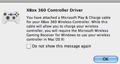

-I plug in the controller, and I get a message that says:
Do I need a wireless receiver? I read somewhere that the controller I had worked fine without one.

Does the driver just need to be updated? I don't understand why this won't work, and neither will any of the fixes.
Is there anything else I can try?
You can't use the wireless controller with the play and charge kit. That's why you get that message. It only works as a charging cable with a PC or Mac. I think there is a wireless receiver sold for Windows so it can be used with a PC but I don't know if it will work with a Mac. The alternative is to use a standard wired Xbox 360 controller.
thanks for your help!
sigh ok...i just bought a mad catz 360 WIRED controller from target. still not getting anywhere with the driver or getting the mac to recognize the device 🙁
