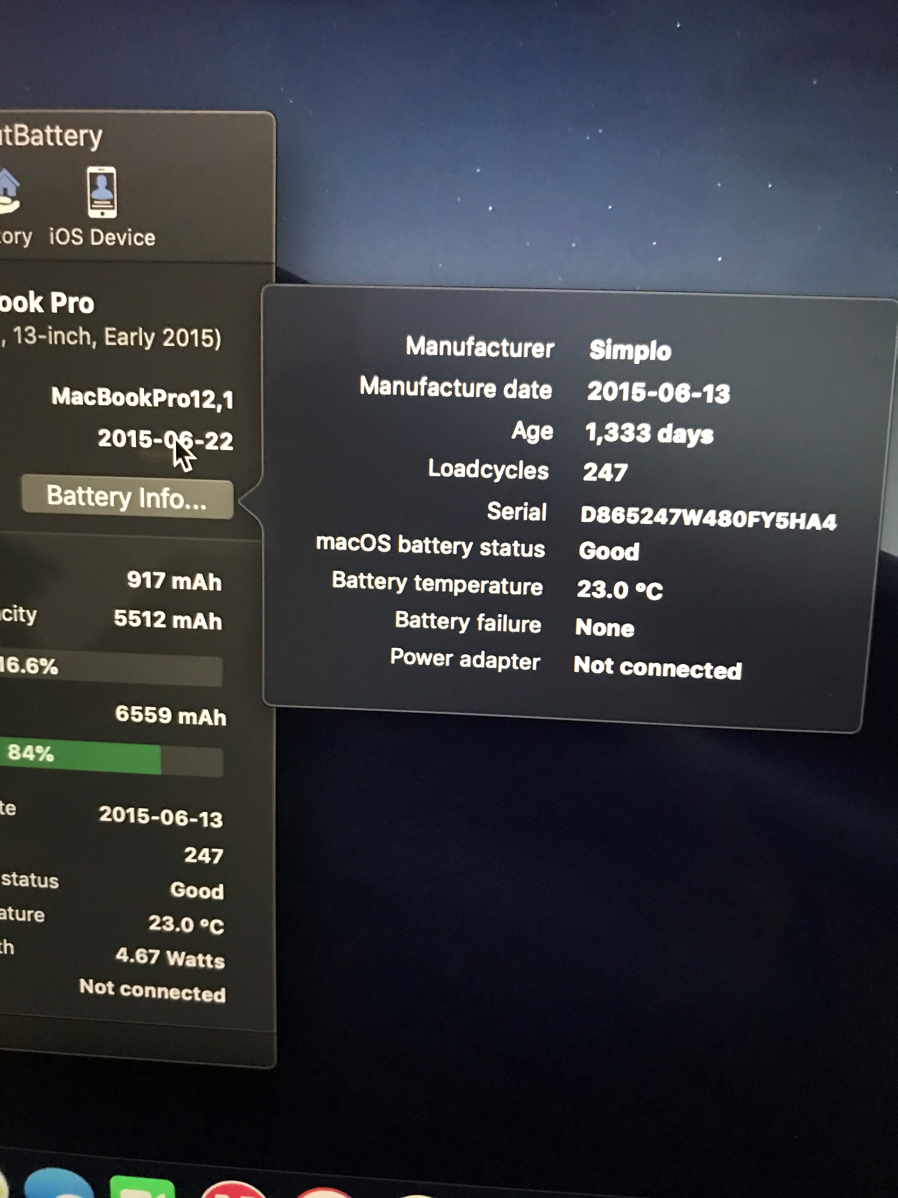

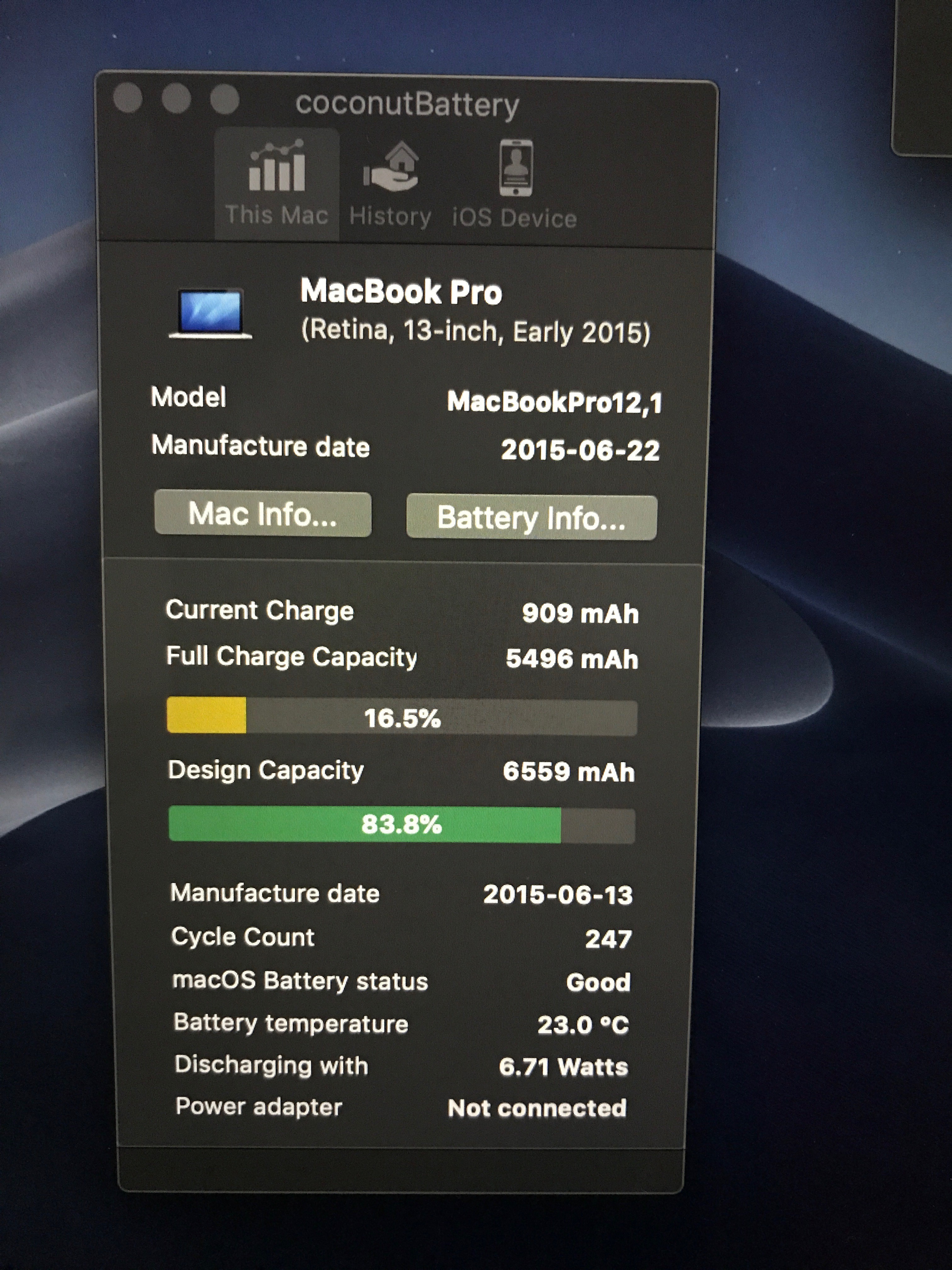

I have the same one and I find it nice and zippy. If you install CoconutBattery, what does it report for battery stats?

Here is what CoconutBattery shows
https://imgur.com/T0MIKc9

Thanks, that looks healthy enough.
