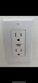

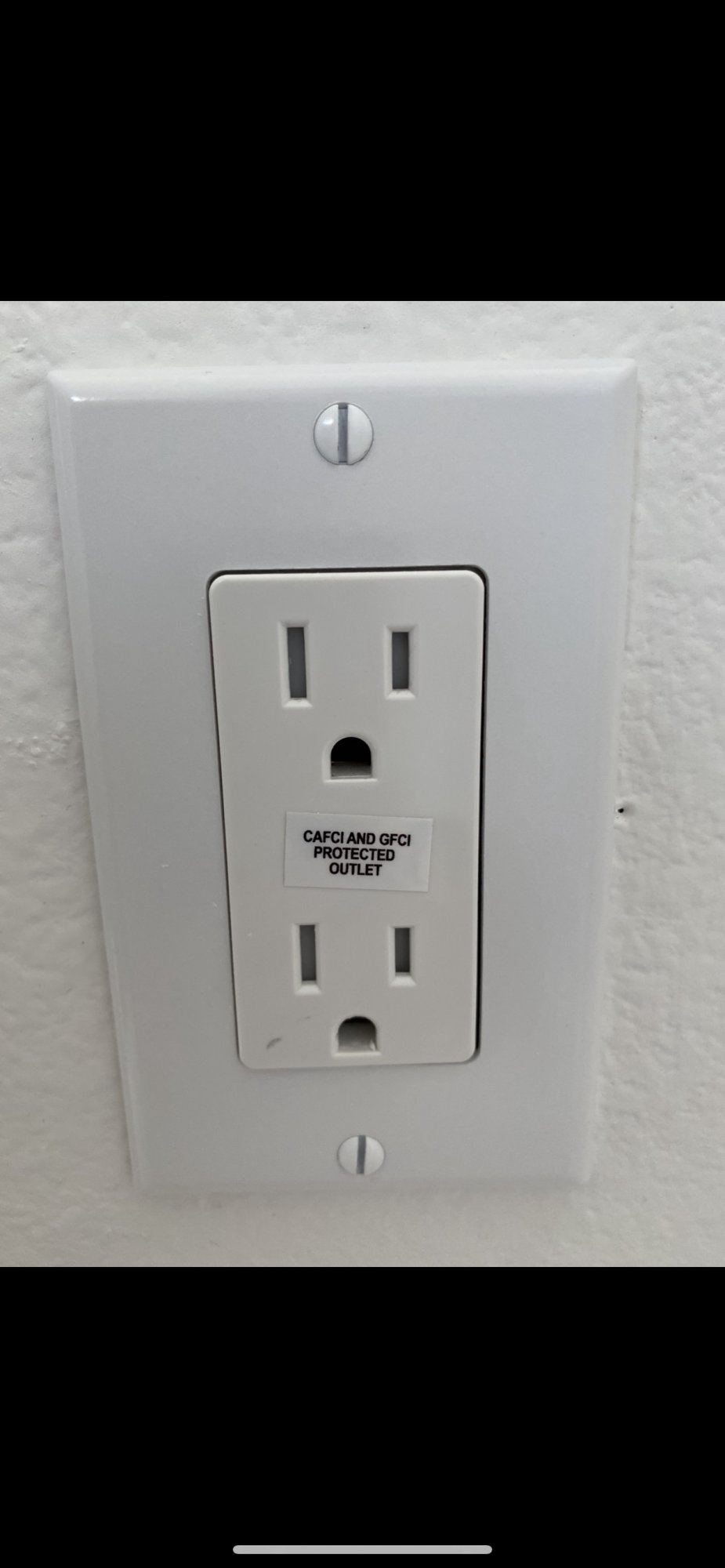

You guys, every outlet in this house looks just like this. Less than half have this sticker on them. I turned the breaker off then on. Anything I'm missing?

That sticker on the outlet should mean that the outlet is protected by a dual-function breaker - something like this one.
Notice that there is both a breaker reset toggle, and a test button on the breaker itself (labeled TEST).
Test the fault protection by pressing the Test button on the breaker. Should cause the breaker to trip.
If the breaker does not trip from the Test button (or you still can't find what actually tripped) - you should call an electrician, who will probably show you what to do the next time that happens :cool:

Those without stickers aren't GFCI protected. You can ignore those. The ones with the stickers are upstream of a GFCI outlet or is connected to a GFCI breaker. I'm guessing there is a GFCI outlet you've over looked. Most have red and black buttons on them, but some newer ones have the same color buttons as the outlets themselves. Like this one
Look closely, because if they're the same color as the outlet it's easy to over look them since if all the outlets uses the same face plates. I would look at the outlets nearest the breaker box and move upstream from there. Check the outdoors outlets too, because most outdoors outlets would be GFCI protected. Check near sinks and other "wet" locations where they might place an outlet.

None that I have found have a test button.
Every outlet looks exactly like the one pictured in my previous post, except that some have the GFCI sticker. I feel like I've looked every, even outside. The 'click' I heard sounded like it came from the area of the outlet in question. Is that expected?
