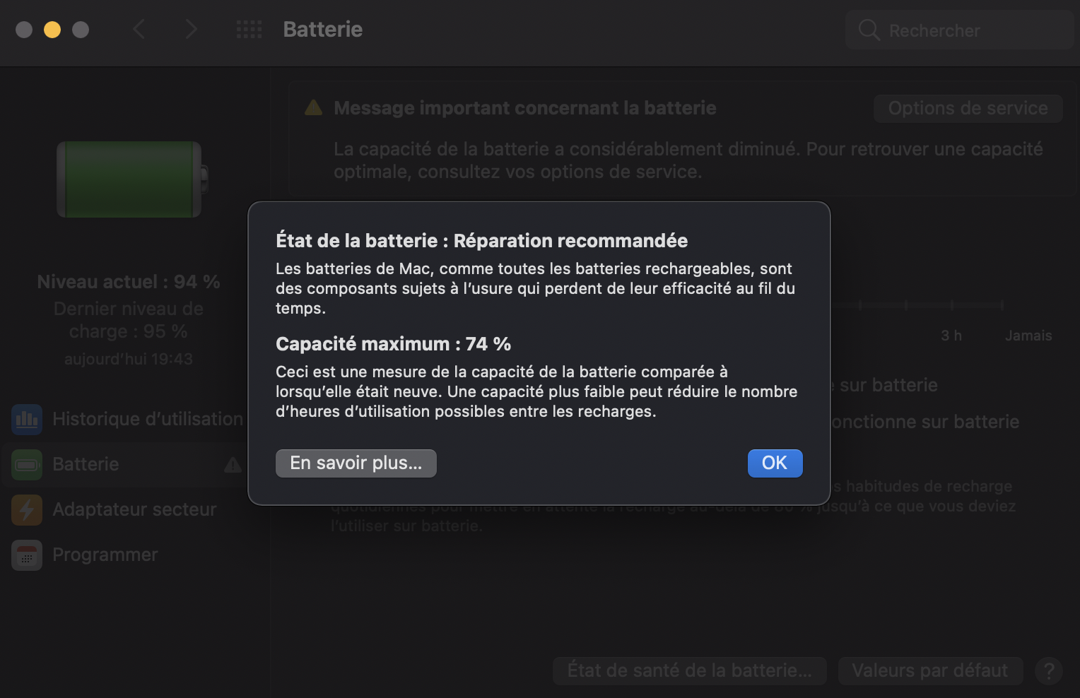

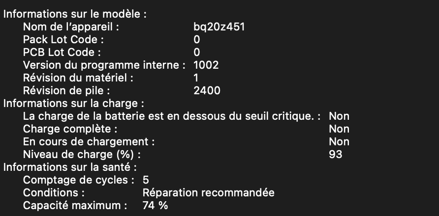

Hello, I am having battery issues with my new MacBook Pro - M1 chip, just purchased it and received it yesterday.
By clicking on the battery icon I get the message: "the battery capacity has decreased considerably" - the maximum capacity is 74% when I just bought it new. The number of battery cycles is 5 ...
Is this a software or hardware issue for you?
I have a feeling that this issue is impacting the charging of the Mac battery. According to Apple after-sales service, I have to have my Mac physically repaired, but it seems to me to be more software.
Thanks for your help.

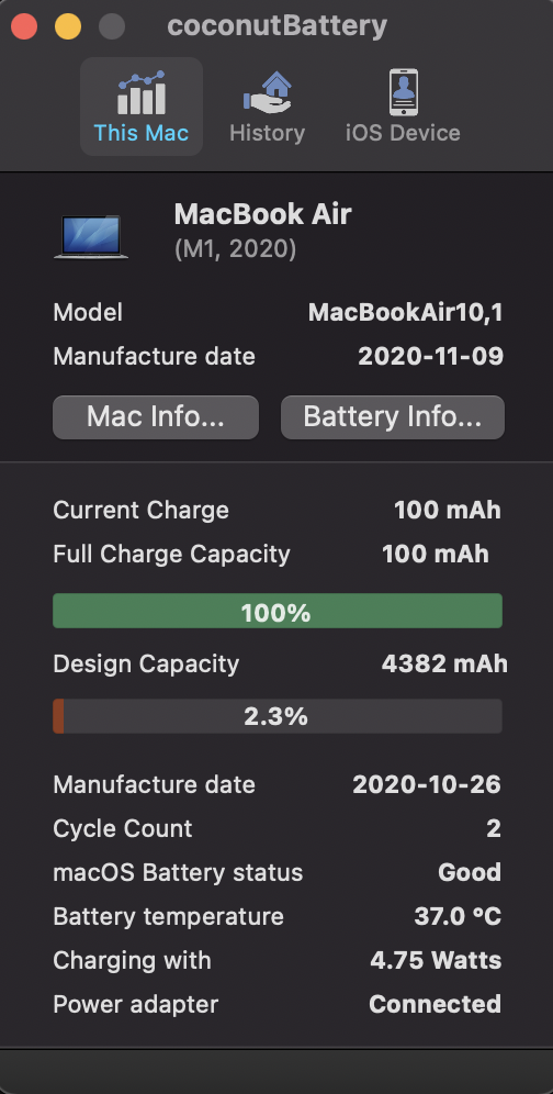

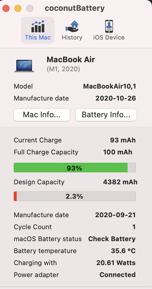

You could try Coconut Battery to check whether it shows a battery issue or not.

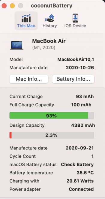

Note that Coconut Battery may need some updates. The preferences window is blank. It also seems to be showing incorrect capacity data on my M1 MacBook Air:

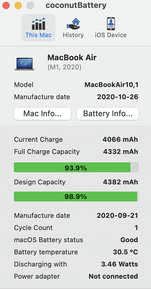

[EDIT] Updated and working correctly now! My design capacity now shows 99.6%

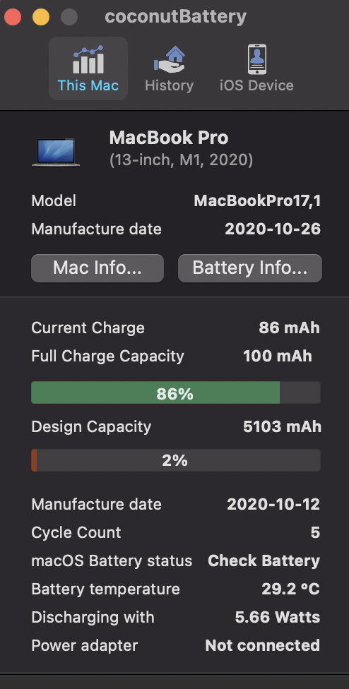

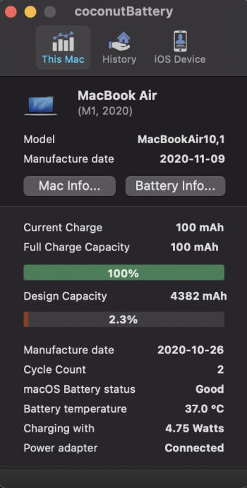

Thank you for your answers. Coconut gives me strange results too.

Same here
EDIT: There's a beta-version for M1 and it's working fine...

Still big battery problems on my side (MBP - M1), no update coming I contacted Apple they will fix the Mac for me. Coconut gives me changing news all the time. The last big bug, my battery remains blocked at 100% for a very long time and then decreases entirely in 1 hour. I hope the repair will be effective.
