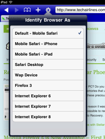

this is not an direct answer to your issue, but if you cannot get it to work I would suggest alternatively trying Atomic Web Browser. It will allow you to change the user Agent to any of the following:
That page lists User Agent Faker v1.1. The latest is 1.3.2 and I can confirm that it does work for its sole purpose of changing your user agent string on a 4s running IOS v5.0.1.
I just tried it out. While it does change both the http header value for User-Agent and the javascript response to navigator.userAgent it does not change the javascript response to navigator.platform. The iPhone still responds with "iPhone" and the iPad still responds with "iPad."
Weird, I haven't dig into it lately but last time, when they released v6 it was an option to define a custom User Agent String.
Atomic Browser does allow you to define a custom "user agent" string but the javascript property for navigator.platform is a separate element from navigator.userAgent. This means that changing userAgent does not set the correct navigator.platform property. I don't know how many sites use the navigator.platform property, but if any of them do, then just changing the user agent is not enough.
