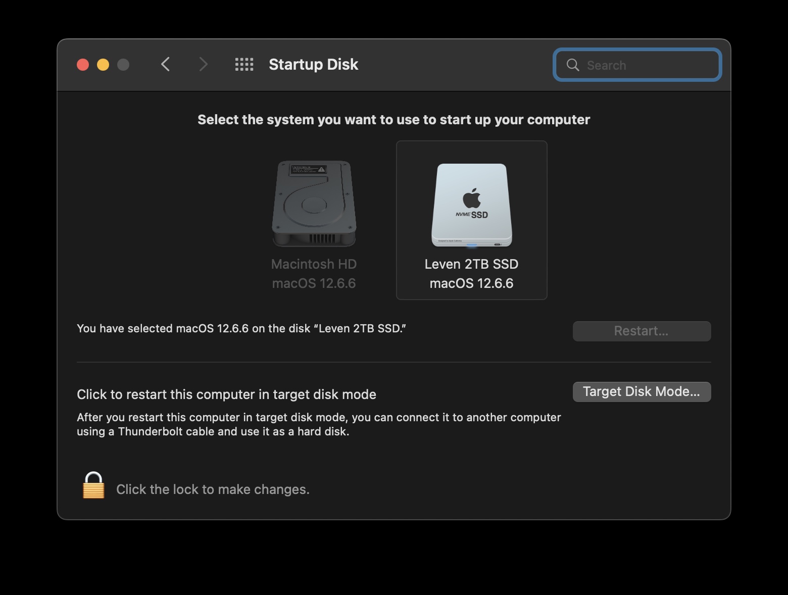

I run my my 2015 iMac 5k from a Qwiizlab M.2 NVMe and SATA External Enclosure with a Leven JPS600 2TB PCIe 3D NAND NVMe Gen3x4 PCIe M.2 2280 ssd. Startup is a bit slower than the internal one did but when on it runs smooth. And I just updated it to 12.6.6 without any problems.
