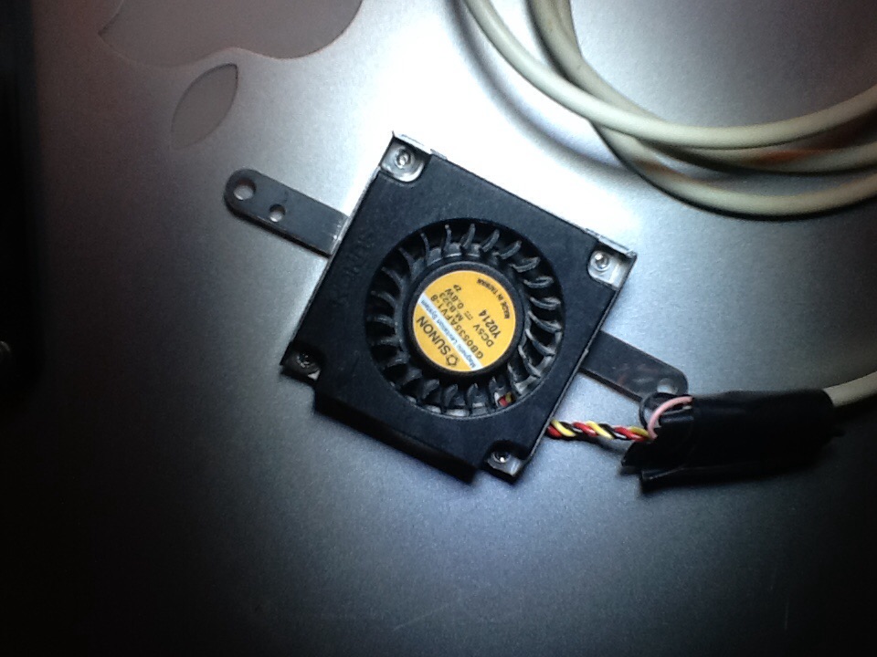

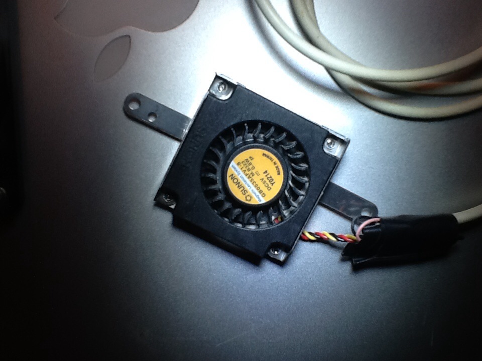

I have an iBook fan I salvaged from my Radeongated iBook. It is a laptop fan and it sucks in air from the top and blows it out the side. The air doesn't come straight out the side, it comes at an angle. It runs nicely at 3v, but at 5v (full speed) it is loud and whiney.

Ok I tested it.
It is too thick. It looks like it will fit with the cover on, but there would be no room for air to get in the top. It may fit if the keyboard were removed, though. My keyboard is defunct anyway... hmm
Other than that it would probably work. The fan can be mounted adjacent to the heatsink. It is smaller though so it would need to work harder to keep cool. A special mount would need to be designed to attach it in place.
Both fans are 5v so they will run properly. The iBook fan has 3 wires while the MBP fan has 4, so it looks like the speed sensor would not work.
The plug from the MBP fa would need to be cut off and spliced to the iBook fan wires. There would be plenty of space to fit this though.
If it was thin enough then it would work. It would probably work if the keyboard were removed.

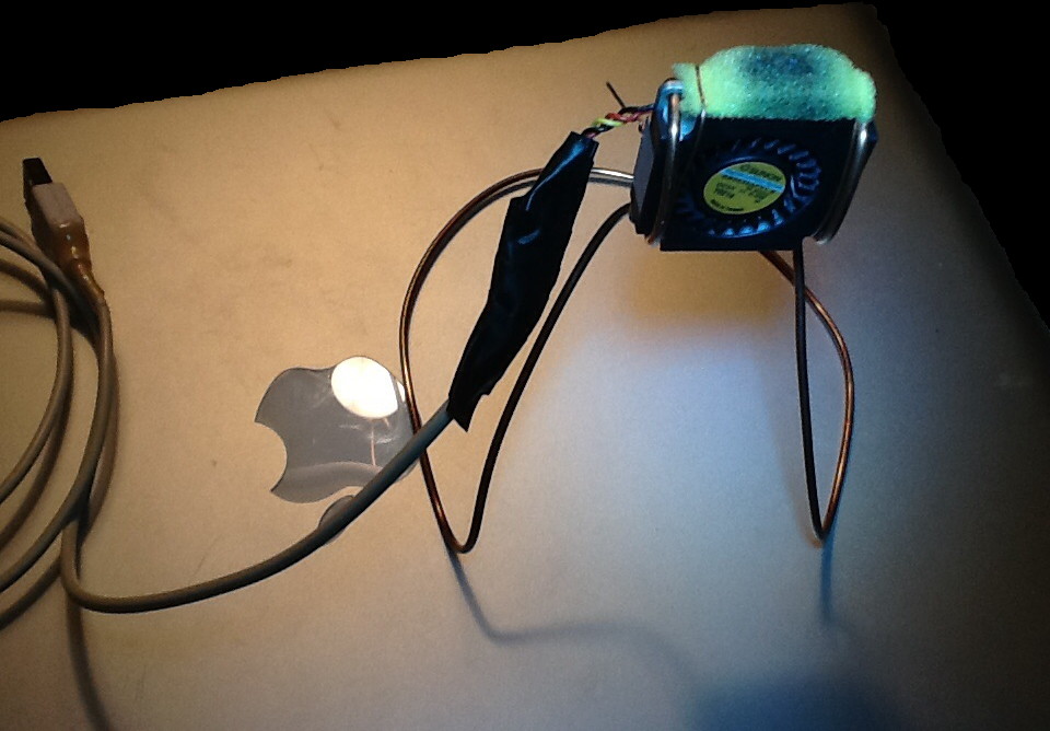

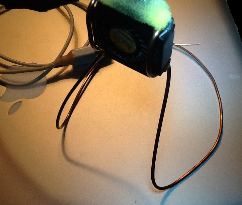

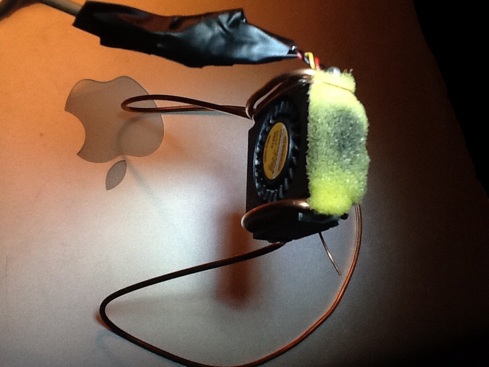

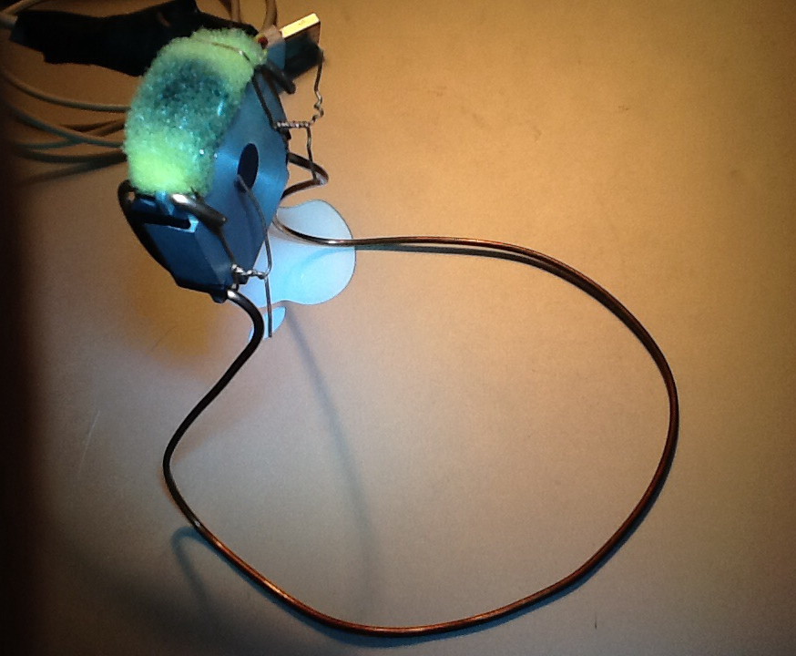

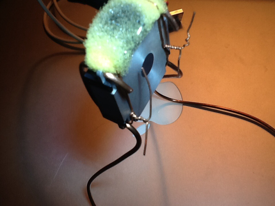

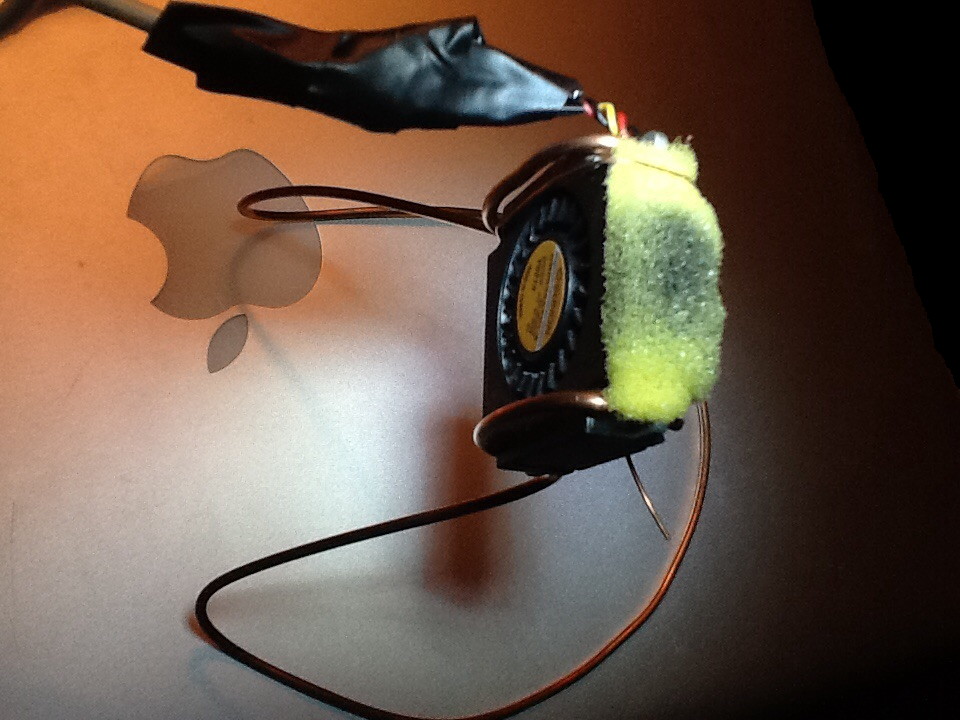

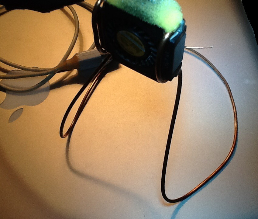

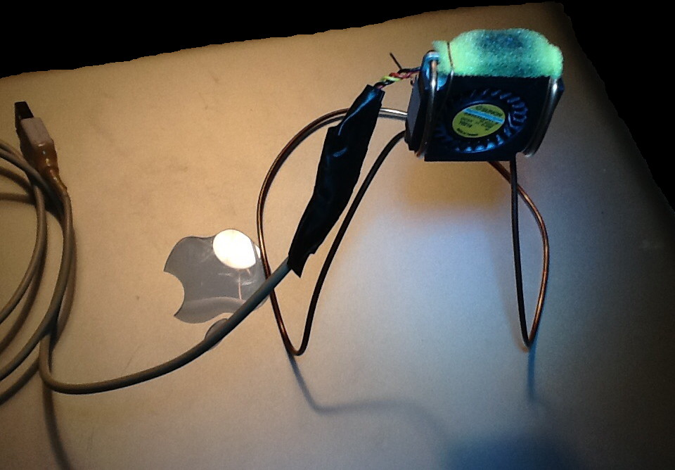

I made a stand and made a filter for the fan. I used a sponge and filled it with activated carbon, but it didn't work. I need something else.
It's hard to find a filter that fits on this fan. You don't want something that bulges inward, or it touches the propellor. Also you need to keep the soldering really close to the fan, about 2-4 inches. I don't know if this is really a good idea 😕 A desktop fan would be much better!
Looks like you gave it a pretty nice shot. That sponge is a lot thicker than I would have used, so it's probably providing too much resistance to the already low powered airflow.
In my setup, I use charcoal sheets which are about 1/8" thick and big G5 fans, so there was lots of air movement. Good job with the quick build.
Actually no, the fan pushes plenty of air through. The problem is the carbon doesn't spread the entire sponge so the fumes go around it. I need charcoal sheets where the entire thing is infused with carbon.
