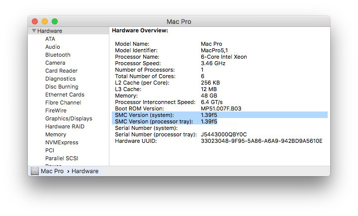

How can I be sure that the SMC will match?
Cheers,
Ed
Thanks!
Cheers,
Ed
Almost all 4,1 tray and logic board out there are with this SMC version. So, I won't be worry too much. Any, if the SMC version doesn't match, the CPU tray will still work, but all CPU related fan will spin to 100%.
