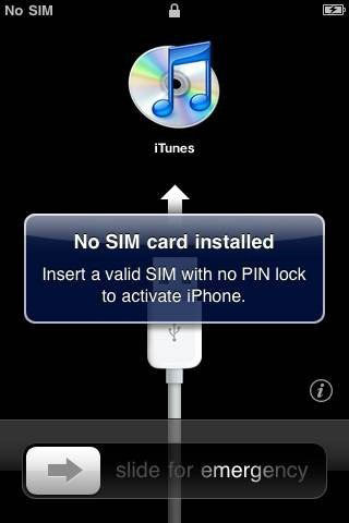

If its already activated you can use it as an ipod touch.
If you even restore it or update the firmware it will need to activate.
You cannot get passed the activation screen without a sim period.

But you will need a sim. You cannot activate it without a sim that's all I was getting at.
It needs to be a sim from the network the phone is locked to. You cannot activate an AT&T locked iphone with a Tmobile sim for example.
If its an unlocked iphone you can then activate it with any sim.
If its locked it will only activate from the same carriers sim even if the sim is deactivated or dead for example.
