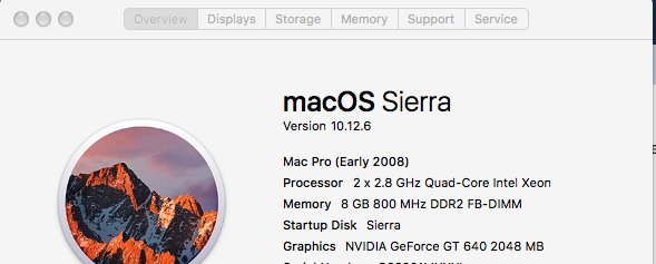

Your 2008 MacPro can run Sierra or High Sierra quite comfortably.

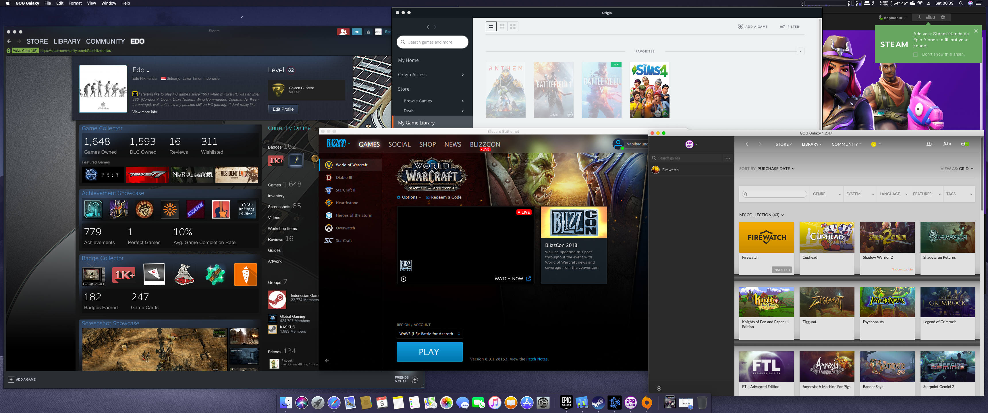

I'm sorry maybe irrelevant but my cMP 2009 also act as my gaming machine
all games that supported Mac very playable with native resolution on my system
