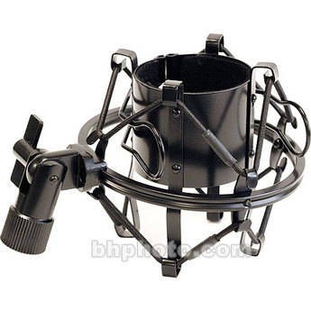

You could try building some kind of shock mount for the mini, like they have for microphones.
