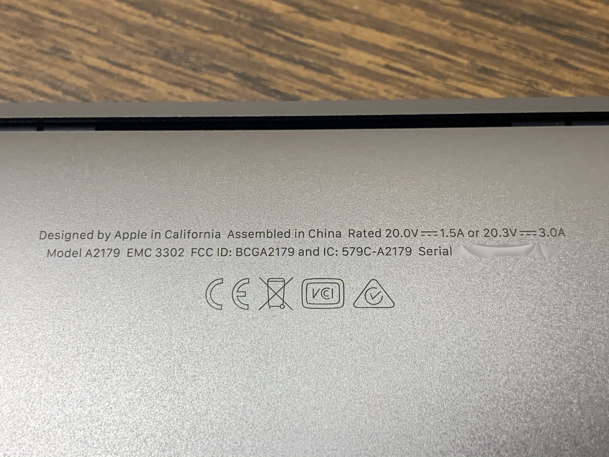

FWIW - at least on the 2020 MBA, it appears it *can* utilize a 60W charger even though it ships with a 30W.
From the bottom case - rated for 20.3V @ 3A

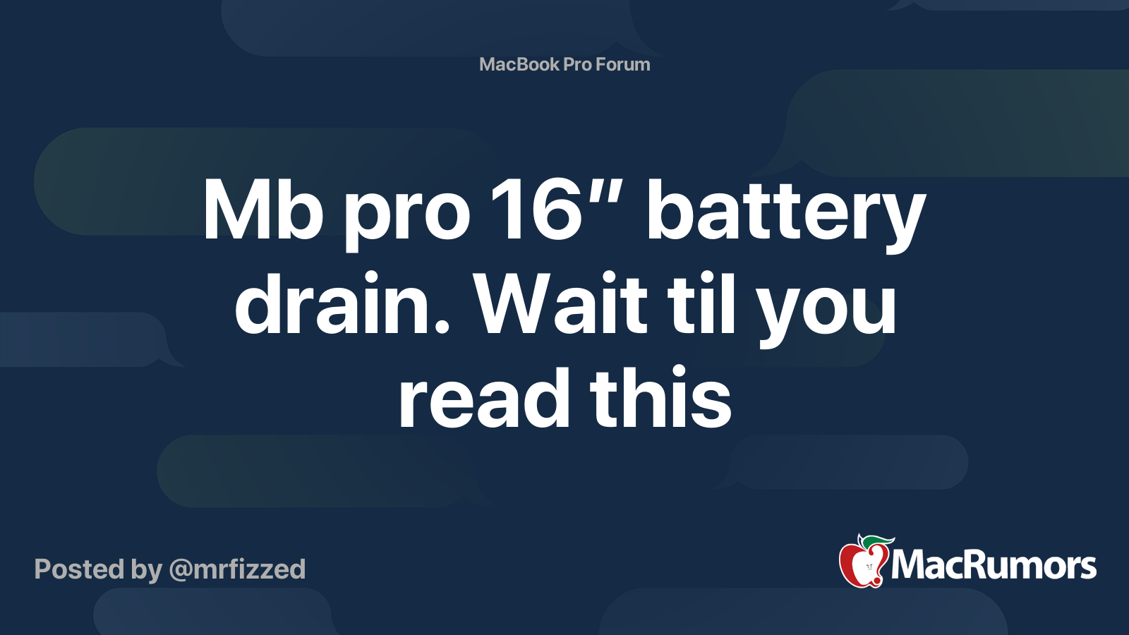

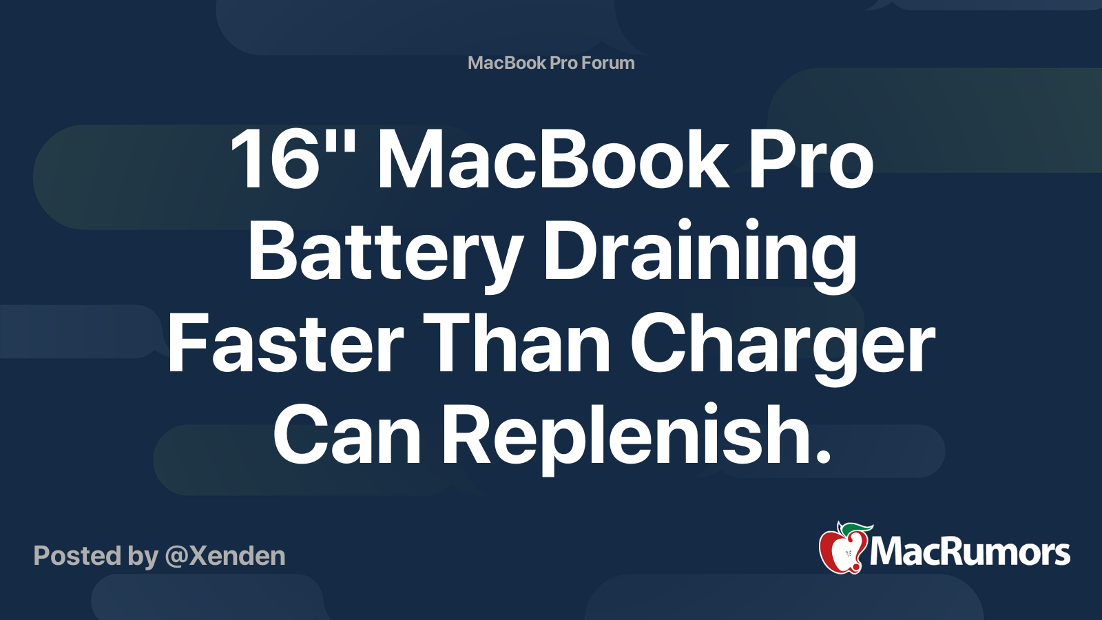

FWIW there've been several reports of the 16" MBP draining when running full-tilt using its supplied power brick, eg
Given this, I'm not all that suprised that the 30w MBA charger can't keep up with an MBA running VC software (Zoom is very poorly optimised for Macs, ie it runs both CPU & GPU at full tilt, all the time) whilst simultaneously casting to a 2nd screen / iPad that isn't itself connected to AC.

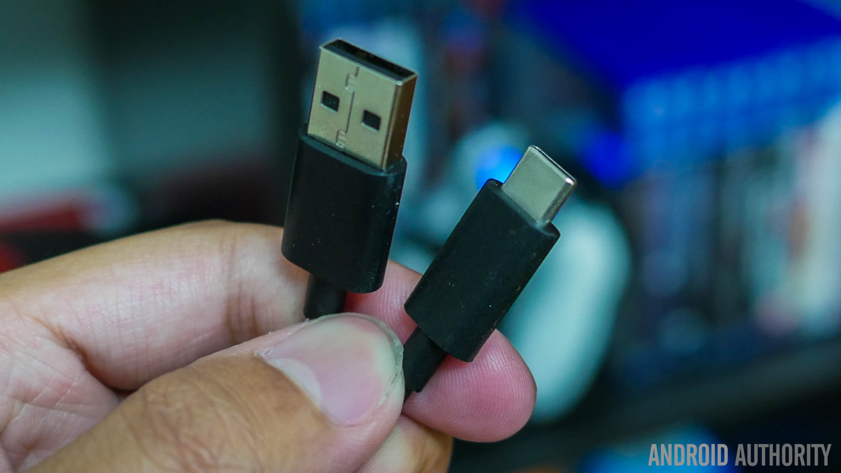

Yeah be careful with USB-C cables.
Some less than honest vendors are selling type-C cables that are not capable of USB-C power delivery (like 15 watts or so instead of 100) and aren't capable of USB 3.x speeds.
They've got a type C plug on them, but that's it; they're USB2 cables in every other way.
If a type C cable looks cheap - be sure to look for the fine print as to WHY.
