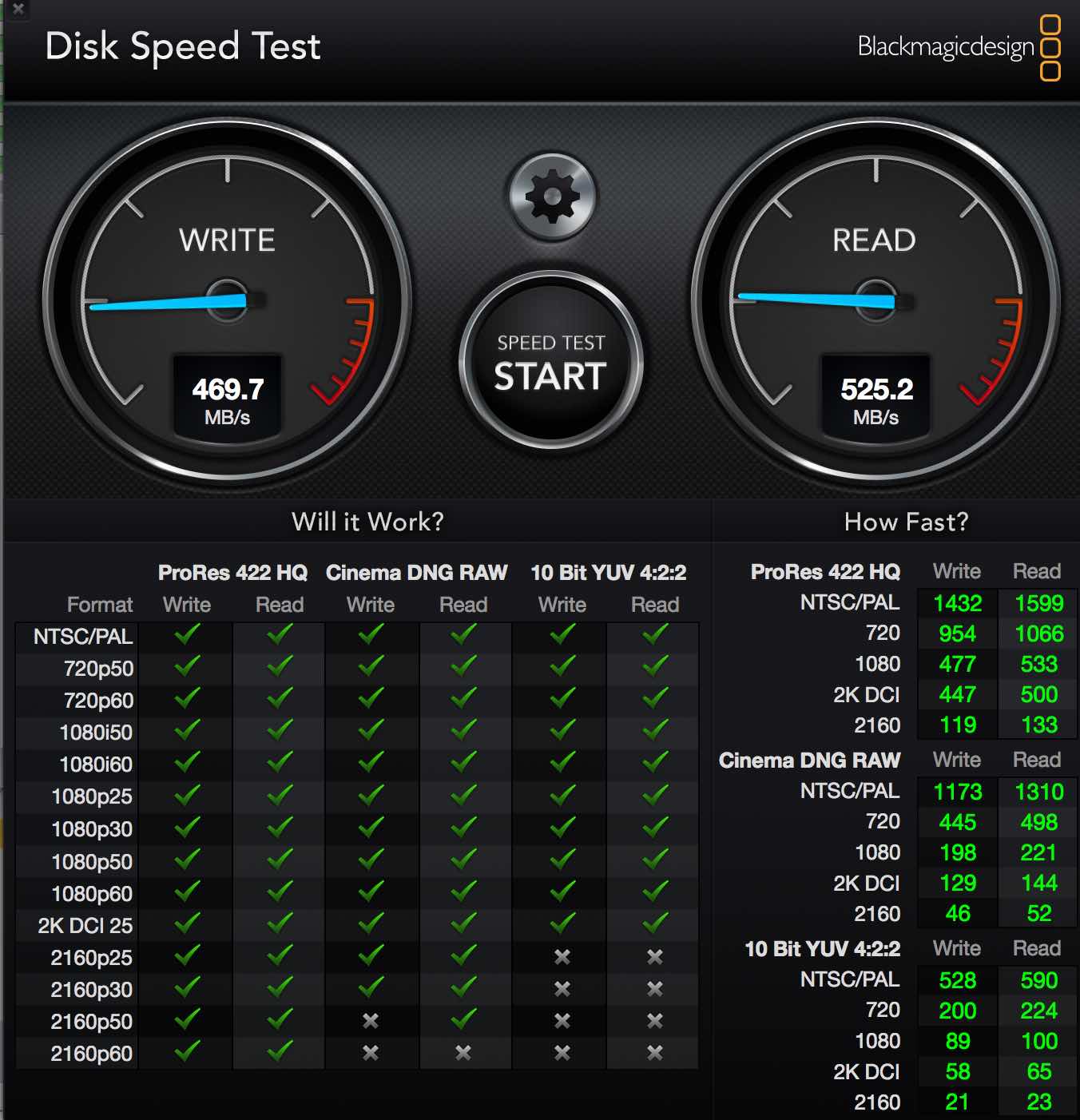

I’m using an external case for a Crucial MX500, but it’s a case that supports USB 3.1 gen 2, which last iMac provides through usb-c port (that also gives Thunderbolt 3 compatibility).
I’ve got also a SanDisk Ultra connected to USB 3.1 gen 1.
The bottleneck here is SATA interface in SSDs... BUT USB 3.1 gen 2 is a little bit faster (430+ against 500+ Mb/s, roughly). Not a big gain... and it depends on SSD also... but a slight difference.

I think that usually reads have better speed than writes.
Crucial MX500 1Tb SATA SSD installed in Plugable case (30€), usb 3.1 gen 2 (usb-C port) to iMac 2017.
