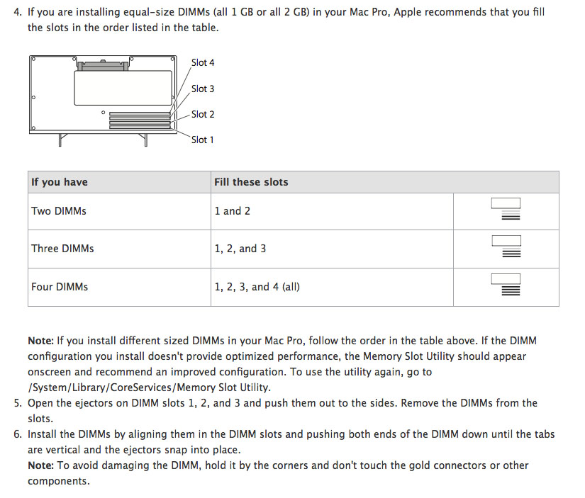

For optimal performance use slots 1,2, & 3. The 35XX, 36XX, 55XX, @ 56XX Xeons have three memory channels. On a 4,1 and 5,1 Mac Pro, Slots 3 & 4 share the third channel. Therefore if you fill channel 1, 2, & 4 you won't see the RAM in the 4th slot. But, using the fourth slot along with the third probably won't be a big performance hit, but there will be some slowdown that you may not notice. However, my preference for my Dual CPU 5,1, I've left slots 4 and 8 MT.

Just to be clear
I have a quad 2.8 5,1. It came with 3GB (WTF?) so I ordered 16GB (2x8GB) from OWC, it arrives today.
I was planning on the 2 new 8's in front, 2 of the old 1GBs in back.
I assume it is better to have the extra gig at a reduced speed than just use one of the old sticks. It's better to have slightly slower 2GB than a faster 1GB when I need the extra space, correct?
^^^^Since you only ordered Two DIMMs you won't get the benefit of 3 channel memory any way, so yes your plan is OK.
Lou

I didn't realize that when I ordered the 2 DIMMs. Bummer.
How much real-world difference would I see with 3 matching DIMMs? Besides the increase from 16 to 24GB.
