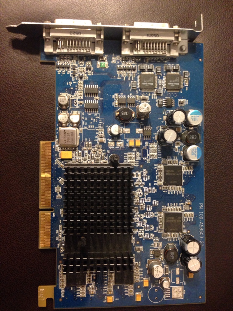

Ih8reno macrumors 65816 Original poster Sep 21, 2014 #1 I have a spare Radeon 9650 and wanted to know if it's possible to use it in a Power Mac G4. I have quite a few G4s and just want to see if I can use it in one of them. Oh and yes I know that's a g3 on the right 😉

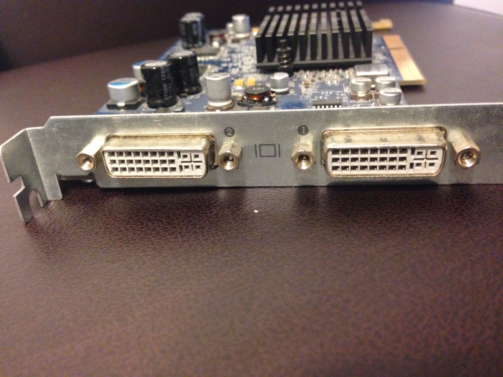

Intell macrumors P6 Sep 21, 2014 #2 It may work in AGP 4X G4's like the MDD, Quicksilver, and Digital Audio. Can you post a picture of the card?
Intell macrumors P6 Sep 21, 2014 #4 That's an OEM G5 ATI 9650. It should work in any of the above mentioned AGP 4X G4's with pins 3 and 11 taped off.
