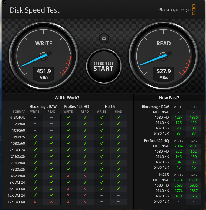

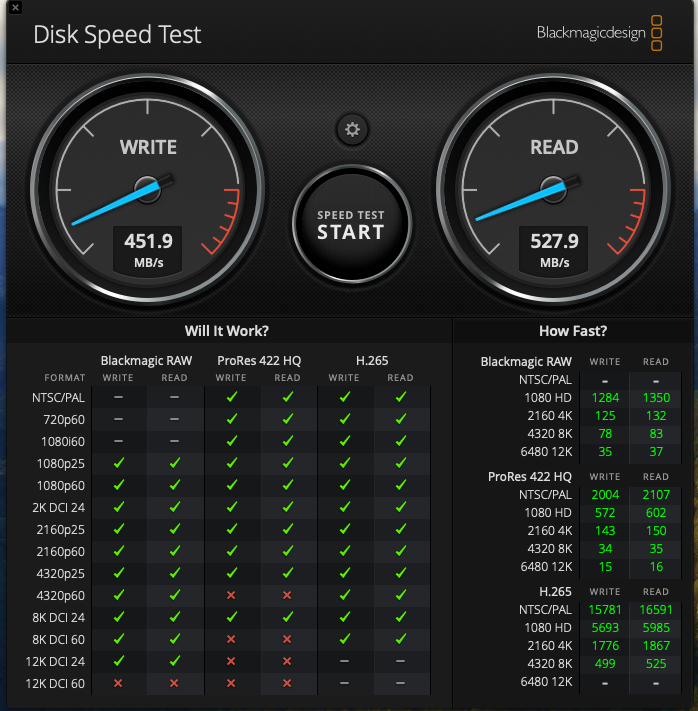

I went with a Samsung 970 EVO SSD. It reaches circa 450 MB/s write and 525 read. That is not a whole lot, I know, but that is sufficient for me.

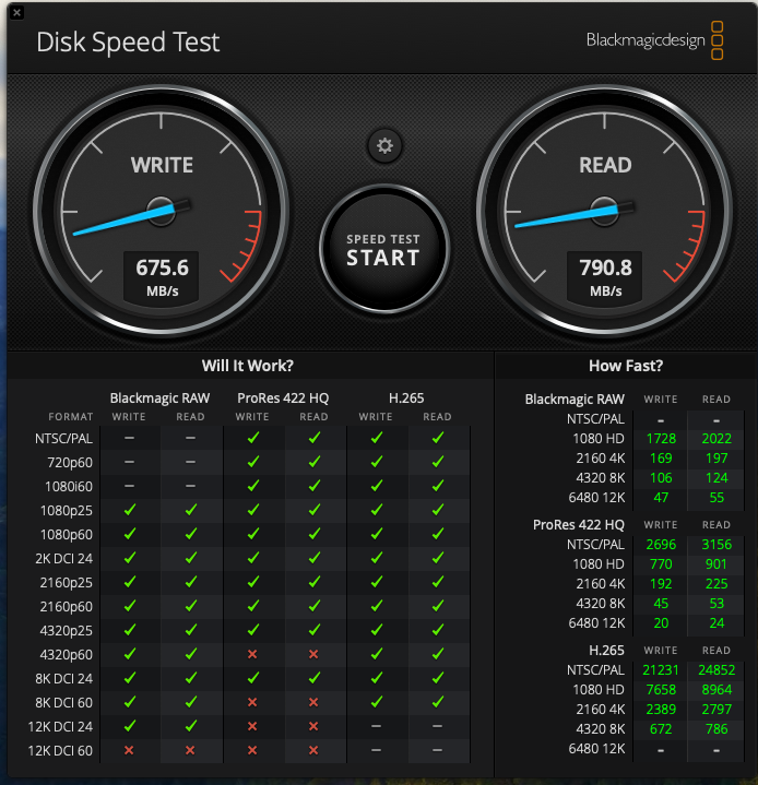

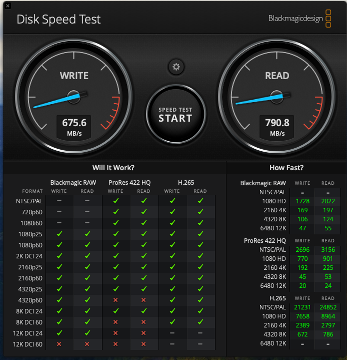

For the M2 I just installed something I had lying around. It reaches 675MB/s write and 790 read.
