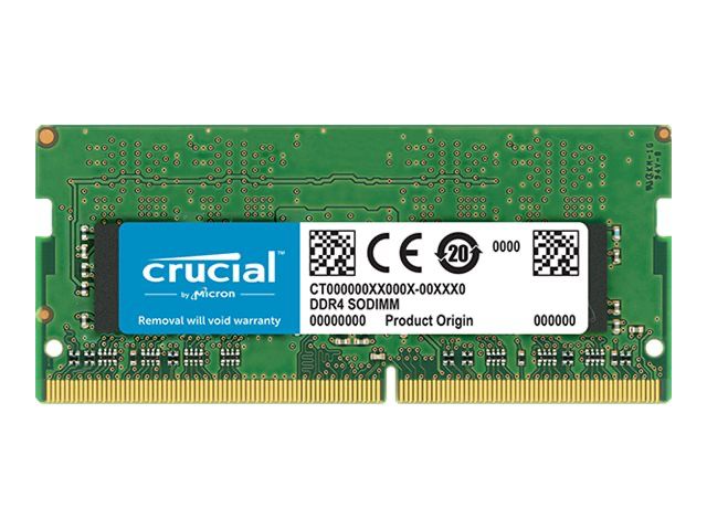

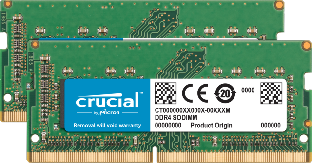

Thanks for the replies! So, what I want to buy is the crucial brand. However, they don't look identical from one website to another, there's design differences. Yet they are all describes as:
Crucial - DDR4 - 16 GB - SO DIMM 260-PIN - 2666 MHz / PC4-21300 - CL19 - 1.2 V - NON-ECC
This model is taken directly from Crucial's official website, which im gonna purchase from since I live in Europe.

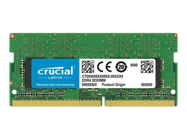

Then there's this kind without the extra details on top, and it doesn't have a "M" in the 00XXX0 description. This is the model I'm planning on purchasing, is this ok and safe to buy for the 2020 model?
(weirdly enough, it's cheaper to buy 16 gb twice, rather than a bundle of 2x16 gb)

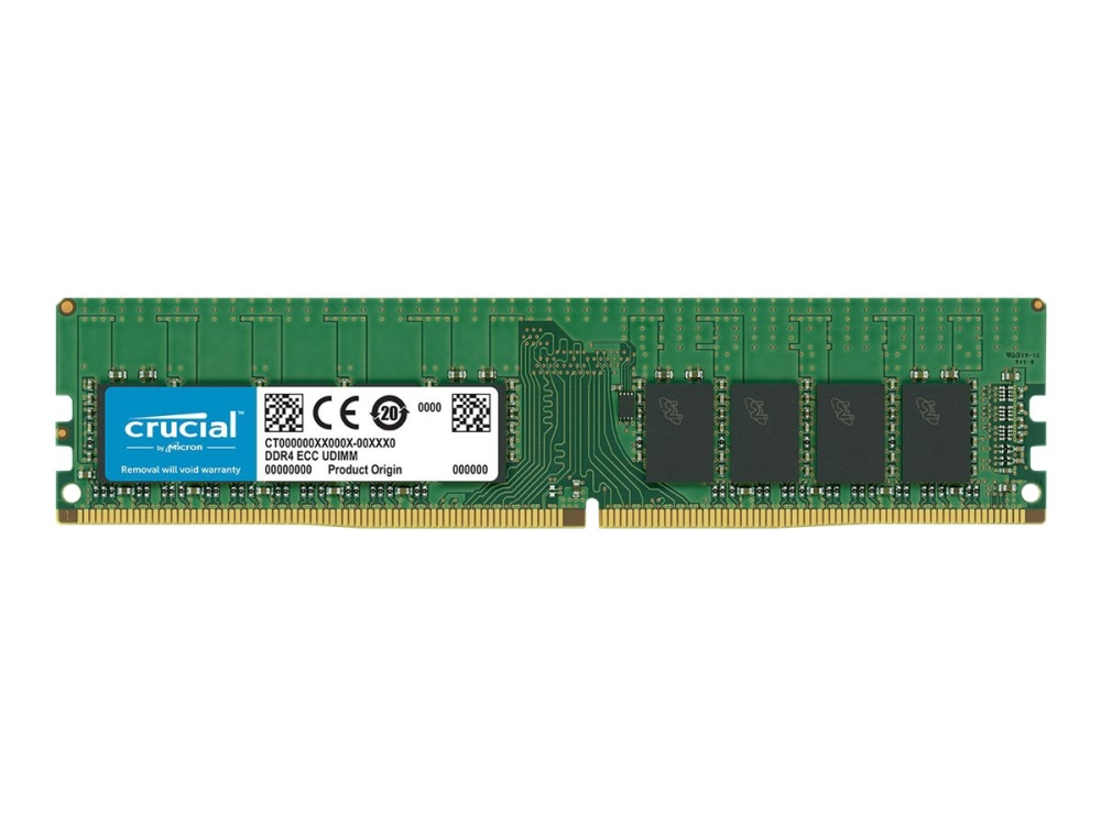

And last there's this weird long kind, which I don't even want to consider cause it looks suspect.

Thanks for the info. I am indeed talking about the new 2020 model. This is the crucial ram im considering. I want to buy a 16 gb twice in a order, since its a bit more expensive if I buy a 2x16 gb bundle
