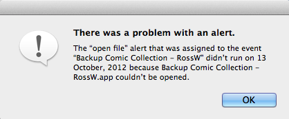

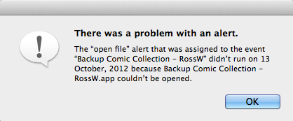

I don't think it's the Automator actions that are the problem - I now see a popup alert from iCal saying that the 'Open file' alert doesn't run because the .app file couldn't be opened (See attached file).

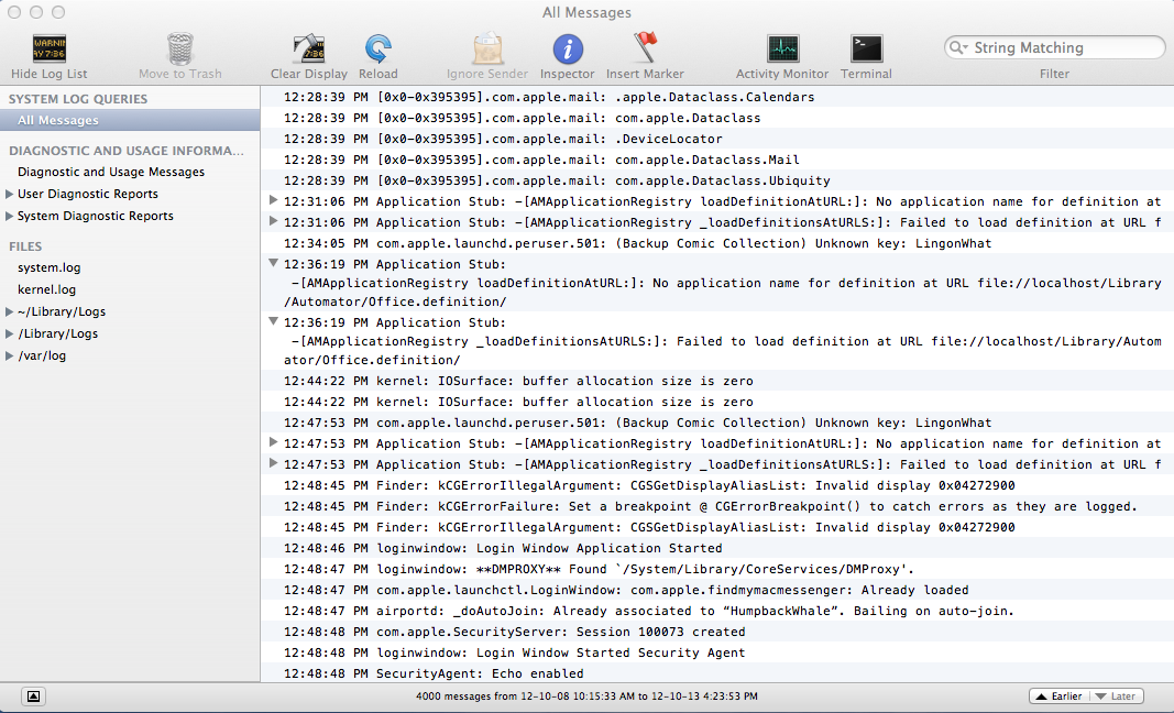

When using a launch agent there's no need for iCal. You said the Automator app runs fine manually but in combination with iCal it clearly doesn't. Check your logs in the Console application for more information why the app couldn't be opened.
Have you checked the Console application? Can you attach your Automator app to your post or describe what the app does? Post a screenshot of the XML configuration file that Lingon made. It should be in your ~/Library/Launch Agents directory. Based on the iCal message it has something to do with backing up your Comic collection. I'm assuming copying files of some filetype from one location to another. If that's the case it should be scriptable with Applescript. Or is there some other kind of voodoo inside the app?

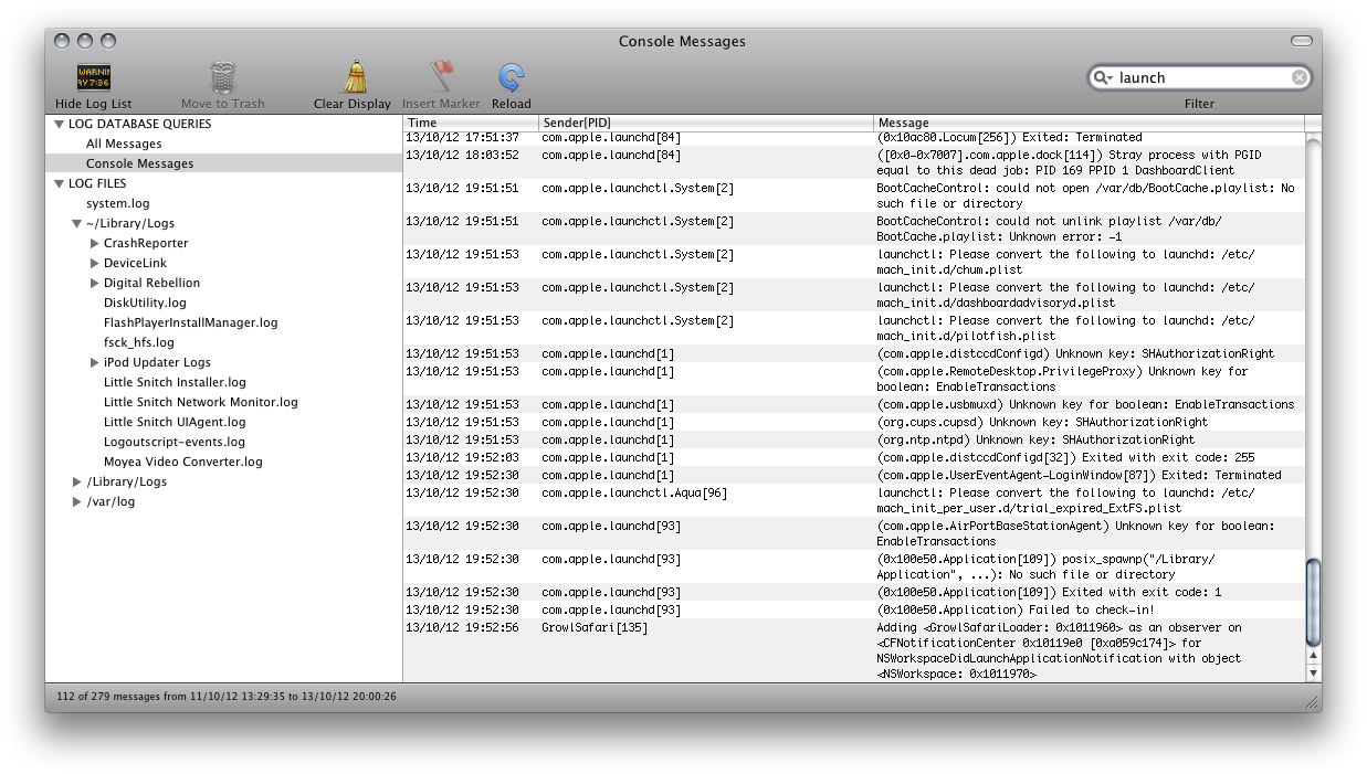

Check the Console application and filter for launch.

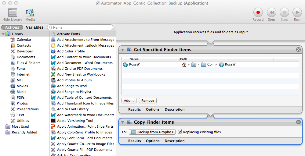

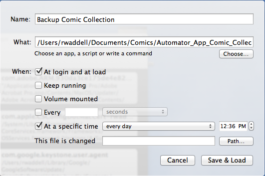

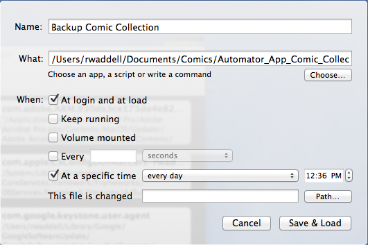

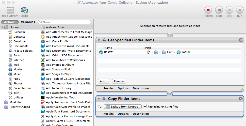

Thanks kryten2 - believe me when I say i really appreciate the help. I've attached some screenshots which I hope explain what I'm trying to do. Basically, I'm just copying a file from a folder in Dropbox to a local folder on my Mac using an Automator .app file. I've included the Lingon config screen and my Terminal output.

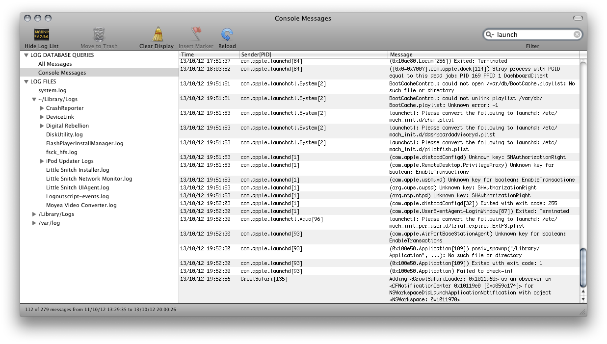

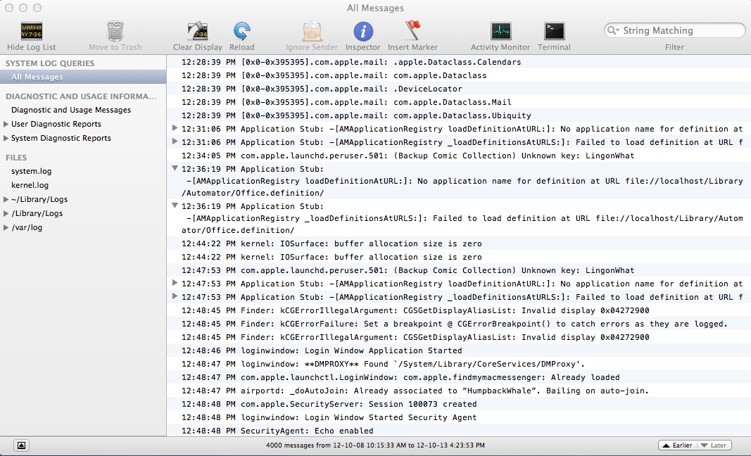

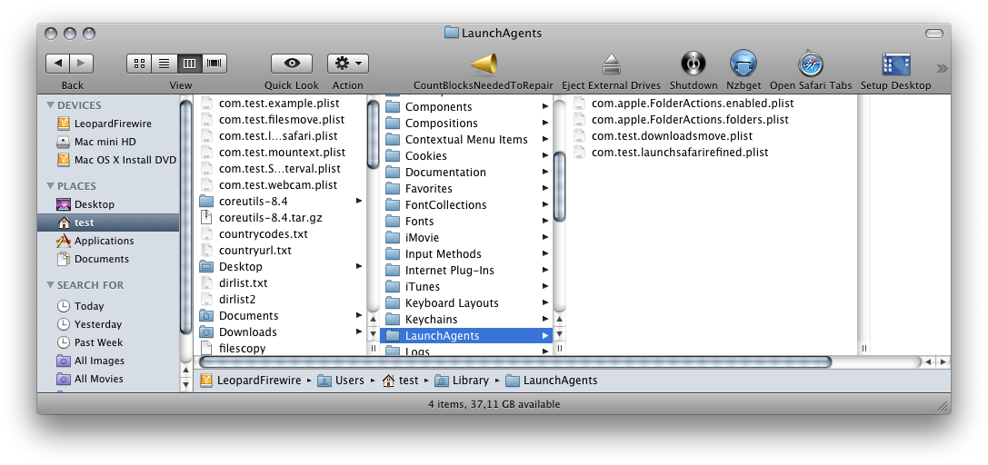

Sorry, I was a little busy answering another post in another thread. Did you notice the line 12:47:53 PM (Backup Comic Collection) Unknown key : LingonWhat. Could you attach the configuration file that Lingon made? It should be in the LaunchAgents folder that's in your user's Library folder and should have Backup Comic Collection in its name. I attached an example screenshot of mine. Give me a couple of minutes to absorb the information in your post.
Edit : Can't really make out the paths to the folder in Dropbox and the local folder. Post a screenshot after you run the workflow but when you do first click the results thingy in both actions so the actions shows the resulting paths or screenshots from Finder like mine which show the path bar.

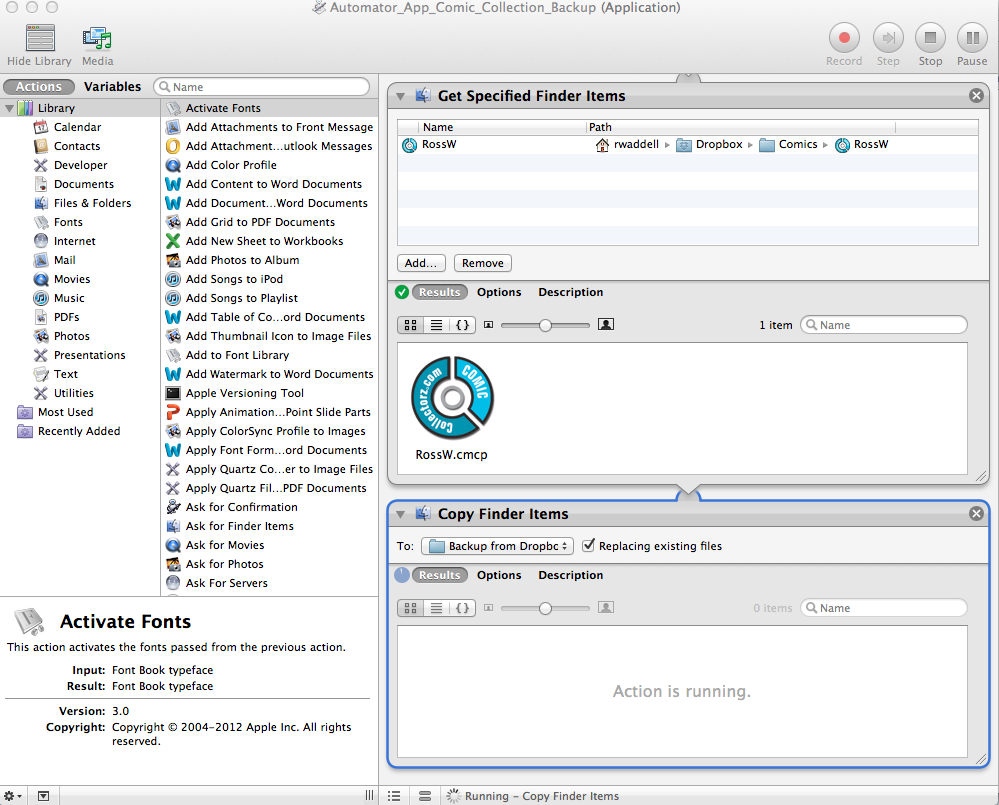

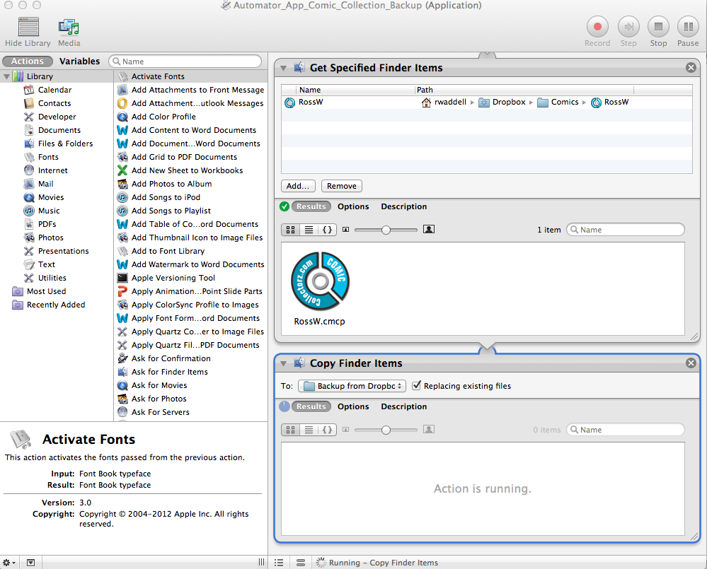

Here's a screenshot of the workflow while running (Automator crashed for the first time on me so it didn't finish).
Dropbox location of source file: Comics\RossW.cmp
Documents location of target: Documents\Comics\Comic Collector\Backup from Dropbox
Is it the spaces in the target folder path?
Copy this script in ScriptEditor and run it to see if it copies the file from the right source to the right destination.

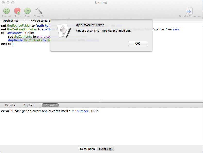

It works! Of course, I have no idea how to schedule this to run every day with Lingon. Do I need to just point Lingon to a saved AppleScript file, or does it need more parameters in the What field?

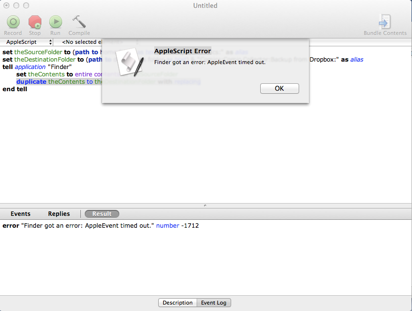

Spoke (slightly) too soon - AppleScript popped up an error saying the AppleEvent timed out (the file is big - about 1.8 GB) although the copy seemed to continue and eventually completed just fine.
Ok, now we're getting somewhere. The time out should be solved with an added statement in the script. Don't know it by heart, will have to look it up. Shouldn't take too long. I would make a plist manually if you can and leave Lingon out of it.

Edit : If an event takes longer than two minutes, the Apple Event Manager reports a time-out error. If 5 minutes isn't enough increase the timeout.
Code:
set theSourceFolder to (path to home folder as text) & "Dropbox:Comics:" as alias
set theDestinationFolder to (path to documents folder as text) & "Comics:Comic Collector:Backup from Dropbox:" as alias
tell application "Finder"
	set theContents to entire contents of theSourceFolder
	with timeout of 300 seconds
		duplicate theContents to theDestinationFolder with replacing
	end timeout
end tell
