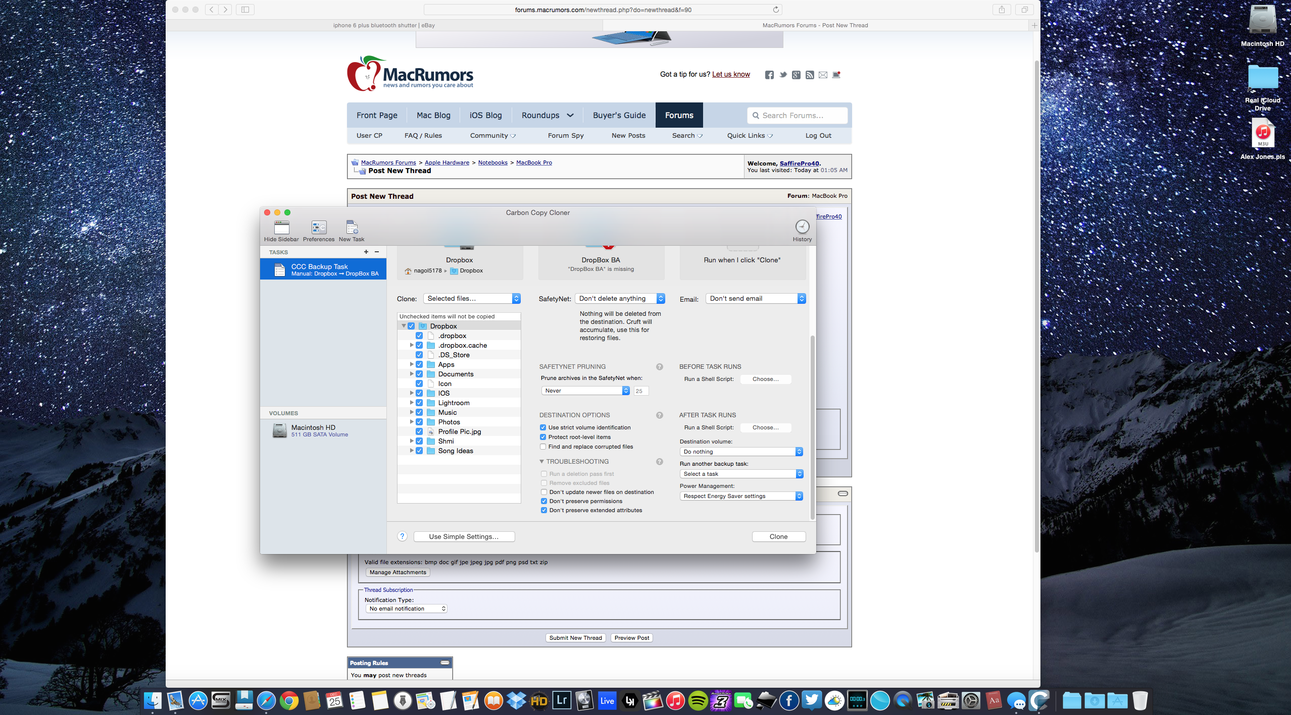

However, should I click, "Don't preserve permissions," or, "Don't preserve extended attributes," when doing so? When I had them unchecked, it seems something went wrong with the backup. When I checked them, it worked fine.
Does, this simply mean that if someone was get ahold of my DropBox hard drive they could view all files without typing in a permission code, unlike they would on my Mac?
I know another way to lock the folder on the hard drive. I am just curious as to what all this does when checking those two.
I opened a few files to test it out, as well as testing if it would delete off of the slave drive if I deleted off of the master drive and all is well. That means if dropbox deletes a folder here or there, I will know about it. This seems easier than copying and pasting and keeping a regular folder as well as a dropbox folder. Plus since the external drive is so big, I have it set up to save files before they were changed and after they are changed.
Any help would be greatly appreciated. Here is an attachment of what it looks like.

That is why you are having that problem with permissions and extended attributes. ExFAT does not support either. Ideally you would want to preserve that information.
Even if you format to the Mac HFS+ (Mac OS Extended) format and just copy with CCC like that, anybody that gets that drive can see your data.
CCC has a built in feature where it can copy the file to inside an encrypted sparse bundle for security (that's what I do). Of course, that will not be readable under Windows.

But the thing is I'm having no problems. I've tried it on both my macs a lot of files, they all worked flawlessly. But with Windows they will not? I know Windows reads exfat.
From my understanding CCC took the authentication codes away, therefore that's why it works on my other mac without typing in any code. It won't do this on windows?
Btw, this drive is going to put in a location where security won't be an issue.
The permissions only makes it so that only you can access it when logged into your account. But this is not secure, as anyone with a Mac and administrator account can modify the permissions of it. It is ok to just turn off permissions.
The extended attributes I think is the metadata like when it was created, modified, tags, etc.

You may be missing data from those files and not know it. For example some of the data embedded in JPG photos might be lost. If you search for "OS X metadata" you will find a lot of information out there. If it is just documents, probably not a big deal.
I have no idea what Windows won't read these files off that ExFAT drive though. It should. If you just drag and drop some test files on the drive, can Windows read them then?
I'm wondering if CCC does not support ExFAT? You might post over on the CCC help forums and ask. The dev. there is very helpful.
