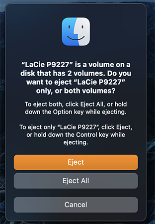

When I updated to Big Sur 11.1, I installing over Catalina then I let CCC update to version 5.1.24. I had previously created a fresh clone of my MBP's SSD with Catalina on a separate external and made sure it would boot and work. I had also gone into Recovery and changed my security settings to allow for external OS booting.
I took a new fresh drive, formatted it for APFS and created a clone of my MBP running Big Sur. I got an error message the first time that said it may not boot. I cloned again and no error message. I checked to see if it would boot from the external drive and it did perfectly.
The only change I have seen is I can not select a startup disk in System Preferences. I have to hold down the Option Key now which is not a big deal.
I have no idea why it works but it does - unless I am missing something from the discussions. I do have an Intel 2020 13" MBP if that matters. The picture is from my last cloning done today.
