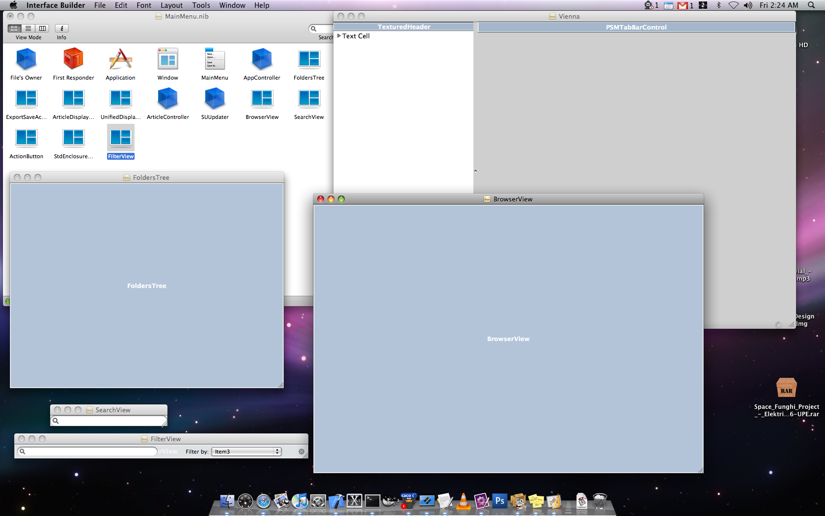

When I opened their MainMenu.nib, it had many custom objects derived from NSView and then each NSView was placed in the main window. I read through the source code and try figure out the architecture but couldnt. I read tutorials on NSView and all of them was about having an NSView when you have to draw a custom control. Thus, I was and am still confused. A screenshot of its MainMenu.nib attached.
Maybe, I should stop looking at other project code and start on my own in simple ways.

I wouldn't try to figure out how Vienna is doing things, it'll probably just confuse you even more. Just take it a step at a time and figure out how your program does things. As you learn more you'll figure out new better ways to do what you've already done.

Even I realised that the best way to learn was to write my own small apps and see what they are doing. Did indeed that for 2 days and learnt a lot but then the curiosity got the better of me again and I opened up Vienna's code. With more careful reading and knowledge gained in the last two I was able to figure out how the NSView and the contros are interacting. Basically they have implemented View for all major controls and then the controls dleegate is the view so all the view code of that control is provided in their corresponding view object. Makes sense.
