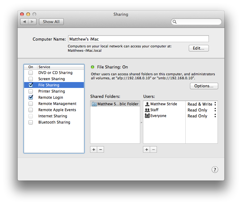

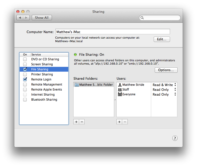

You should just be able to share the disk on your mini and mount it on your MBA.
On your Mac Mini: Go to System Preferences > Sharing > Tick the File Sharing box.
In my case this results in the attached:
On your MBA: Open a Finder window, click Go at the top of the screen > Select Connect to Server and the input the address that was displayed on the Sharing preferences tab.
The Mini should then appear in the finder window under the shared devices.....hopefully!
P.S Never done this, just guessing 🙂
