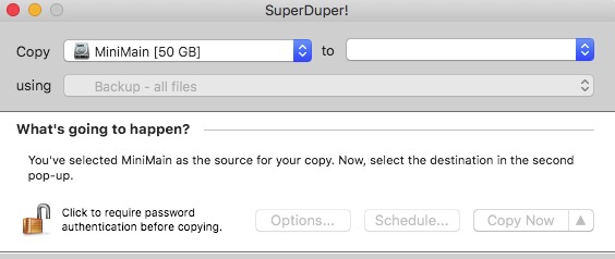

3. Open SuperDuper. It has a VERY EASY interface to understand. Looks like this:
3. At the top of the main window, you want to put the tbolt (source) drive on the left. Put the target (t7) on the right.

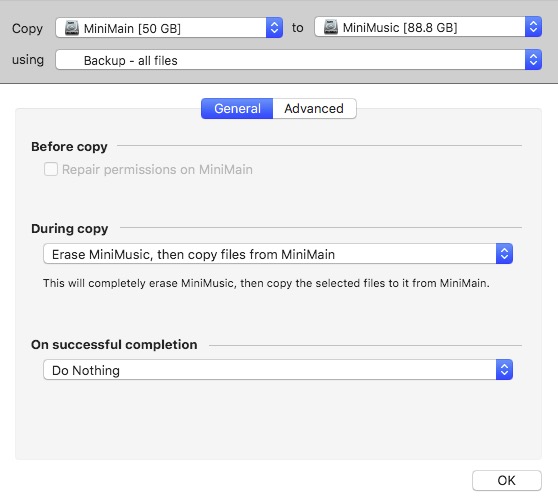

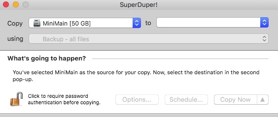

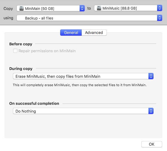

5. Before going further, click the "options" button. You will see this:
6. In the "during copy" popup, MAKE SURE you choose "erase xx, then copy files from xxx".
(this will erase the t7 drive to the proper format for the version of the OS you're using -- which I don't think you have told us)
7. Click ok to go back to the main window.
8. Click "copy now", then sit back and ... wait. When the clone is done, quit SD.
