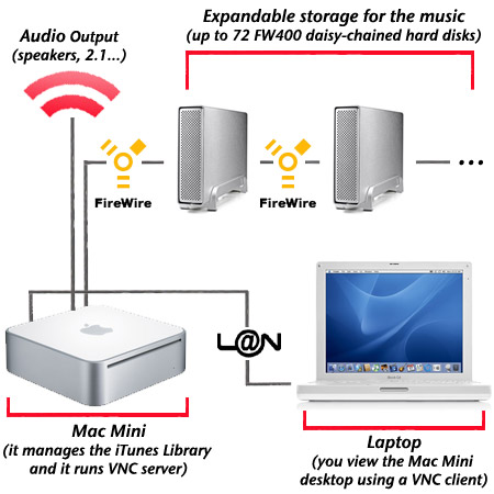

As most Firewire enclosures have two Firewire ports, you can connect one HDD to the iMac, and connect another HDD to the first HDD via Firewire, then you can connect a third to the second and so on. It is called daisy chaining.

There will be a speed loss if you are reading/writing from/to all 3 drives at the same time. The fastest speed for all drives will be determined by the FW lead from your iMac to first HDD. For example your probably using FW800 (800Mb/s) so if your accessing all 3 drives at the same time your speed will be up to 800Mb/s combined not per drive.
You can still access one drive at a time to the full speed of 800Mb/s no matter how many in the chain.
