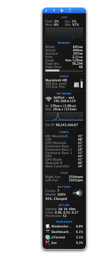

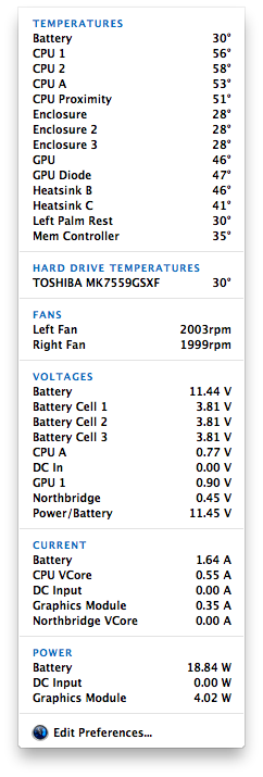

...is the discrete GPU not being disabled on my 2011 MBP when I have the program set to "integrated only"?
in the above, you can see my discrete GPU has a temperature reading dispite gfxCardStatus being set to "integrated only". On my 2010 MPB the "GPU" or "GPU Diode" lines would have a dash (-) rather than a temperature reading, indicating it had been fully disabled. It appears to be affecting my battery life.
Help? Can anyone check and see if this is happening with theirs as well?

believe it or not, the temperature did not change. I left the discrete GPU on about 5 minutes.
on my 2010, the changes in temperature were obvious, as you mentioned. when it was off, the temperatures dropped. when it was on, they went up.

in that case it is working properly. but is it that the discrete never actually turns off like the Nvidia's did in the 2010s? because the AMD GPU doesn't get any cooler despite it not being engaged. in other words, no matter which GPU is engaged, the AMD GPU never drops below 46C.
odd, no?
odd, no?

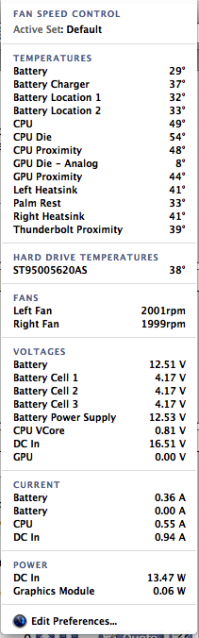

It seems that in my MBP the discreet is off...
fascinating. THAT is what I expect it to look like. That's what it looked like on my 2010 (roughly). I guess I'll retry installing gfxCardStatus. I had been wondering why my battery life on integrated wasn't any more impressive than when using discrete. Maybe even a little worse. Looks like that was because the discrete is still getting power, despite it being technically disabled.
odd.
8*C is like 46*F, nothing is that cold in your MacBook. That temp reading is wrong.
it gets down that low when integrated is active.
BTW reinstalling gfxCardStatus seemed to fix it.
it's now at 10C 😀

to drive home the final point. take note of my current GPU diode.
that is what it cools down to when the discrete GPU is properly disabled. it cools until it's so low it gives off no relevant reading...and then you just see a dash.
