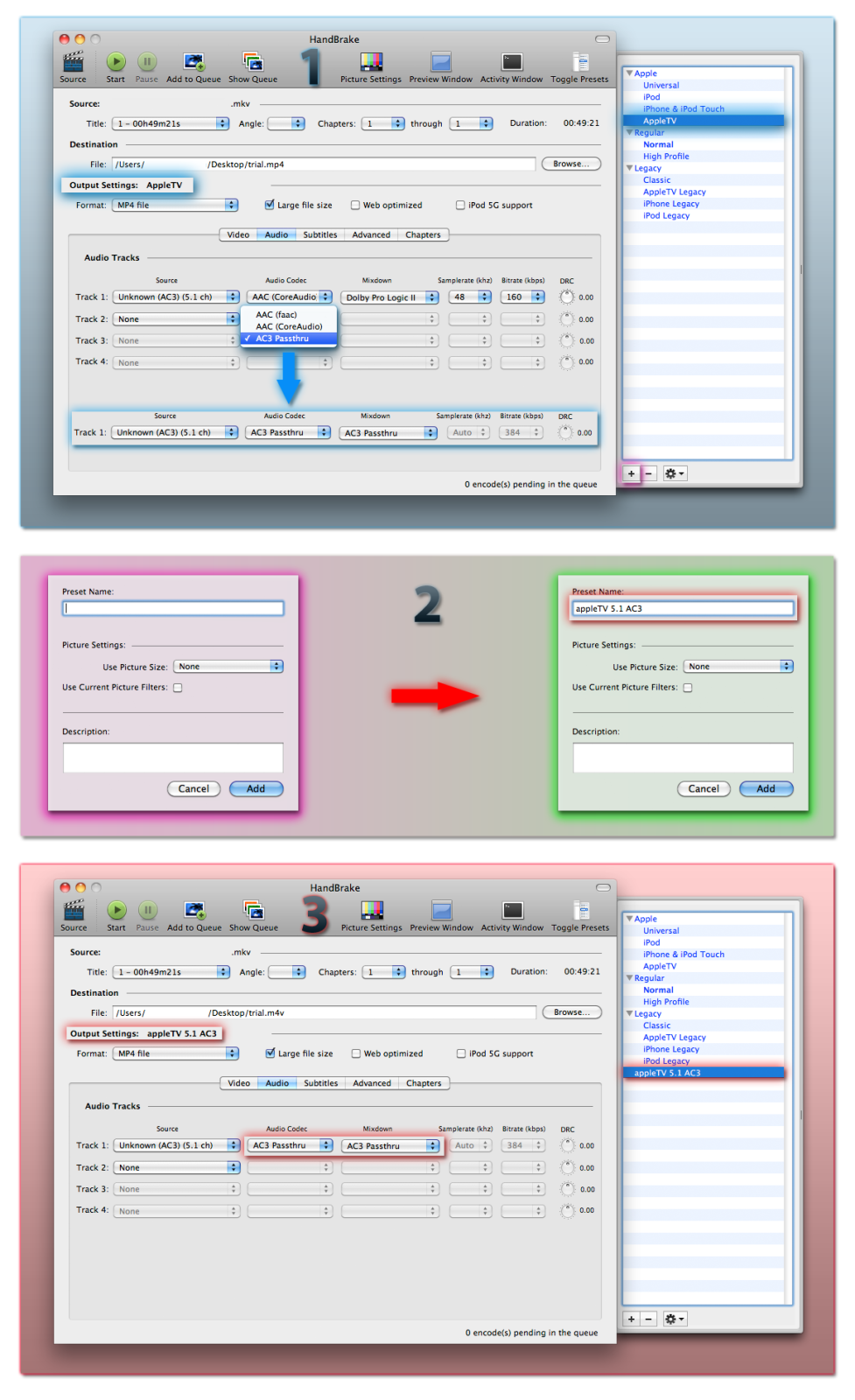

You can transcode the .mkv file in Handbrake.
1.
Just open the .mkv file in Handbrake, use the Apple TV preset (you may have to click "Toggle Presets" in the toolbar), change the audio to AC3.
2.
Save it as preset (click the pink-coloured + sign on the bottom of the Preset sidebar) and give your desired title.
3.
Use the preset on every AC3 enabled file you want.​
Screenshot, attention: large!
Clickable
