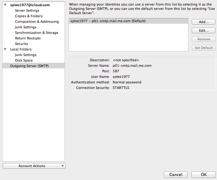

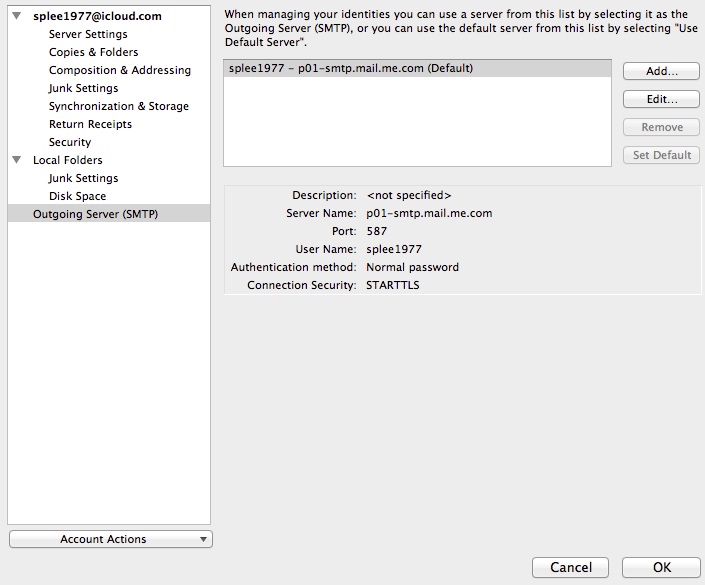

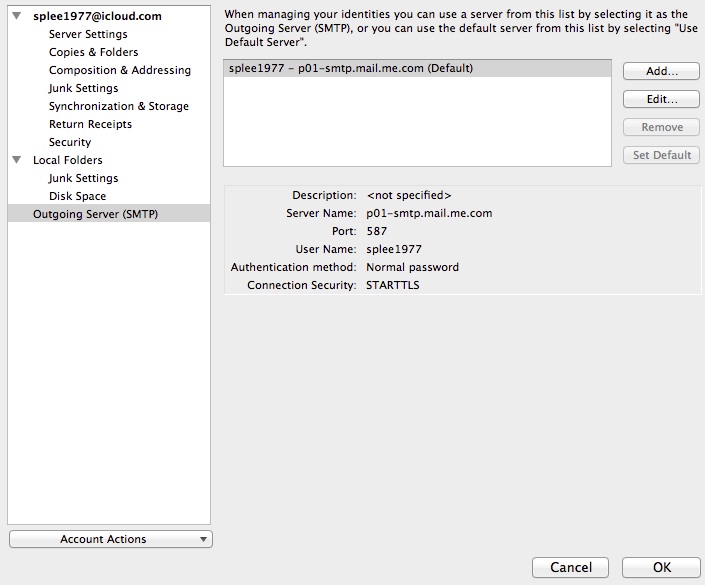

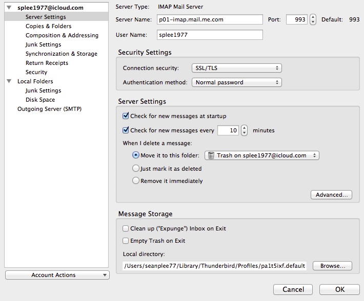

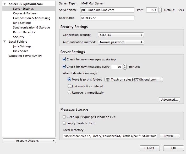

found the solution!
I loaded a couple of screenshots of what I did to get it to work. This is for Thunderbird 31.0
thanks for the help on this guys.
Sean
