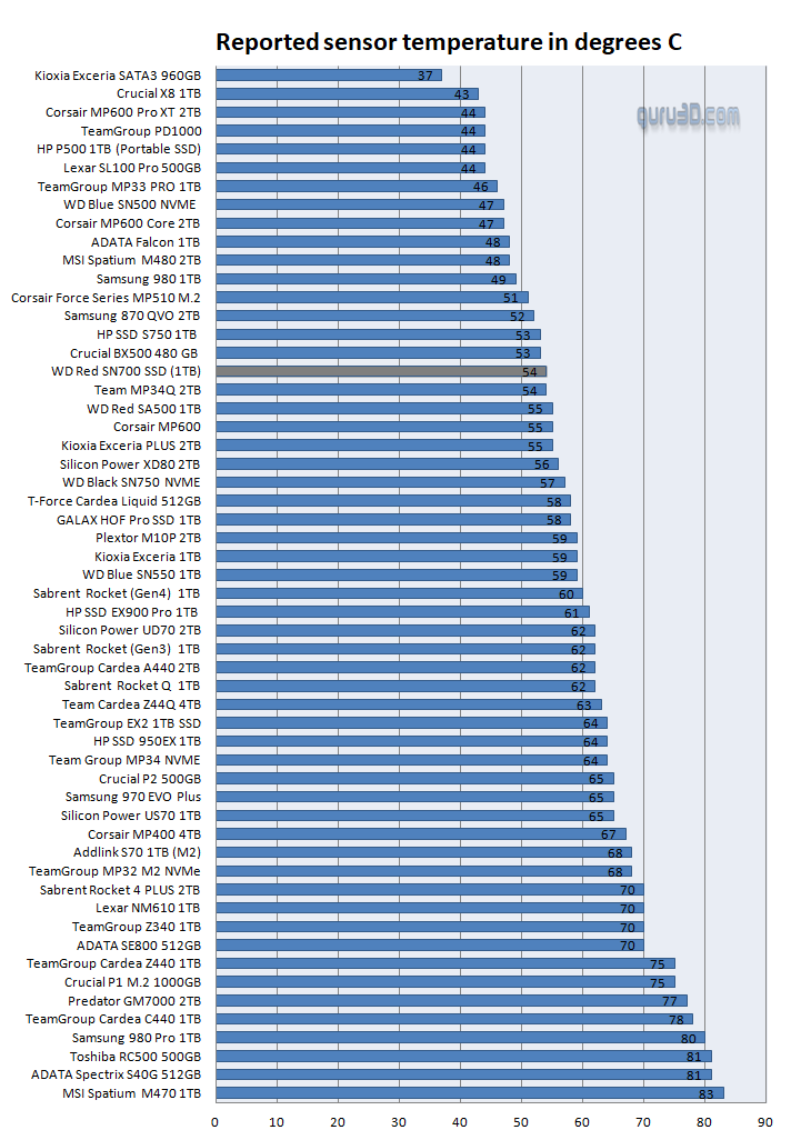

kek don’t have your hopes up too high. After ~150GB the SLC buffer would run out on the 8TB and you will be limited down to ~150MB/s of writes. Good luck producing any heat from that point. How do I know SATA drives don’t run hot? I own both 1TB 860EVO, 4TB MX500, 1TB Crucial P1(m.2) and a 2TB 970evo plus(m.2). When I move 200GB+ once in a while, it’s the M.2 that gets burning hot after while the SATA ones chugging along slowly but never gets more than “warm”, which is like below 50. You don’t need to trust my anecdotal experience, just look at Guru3D’s torture test result
