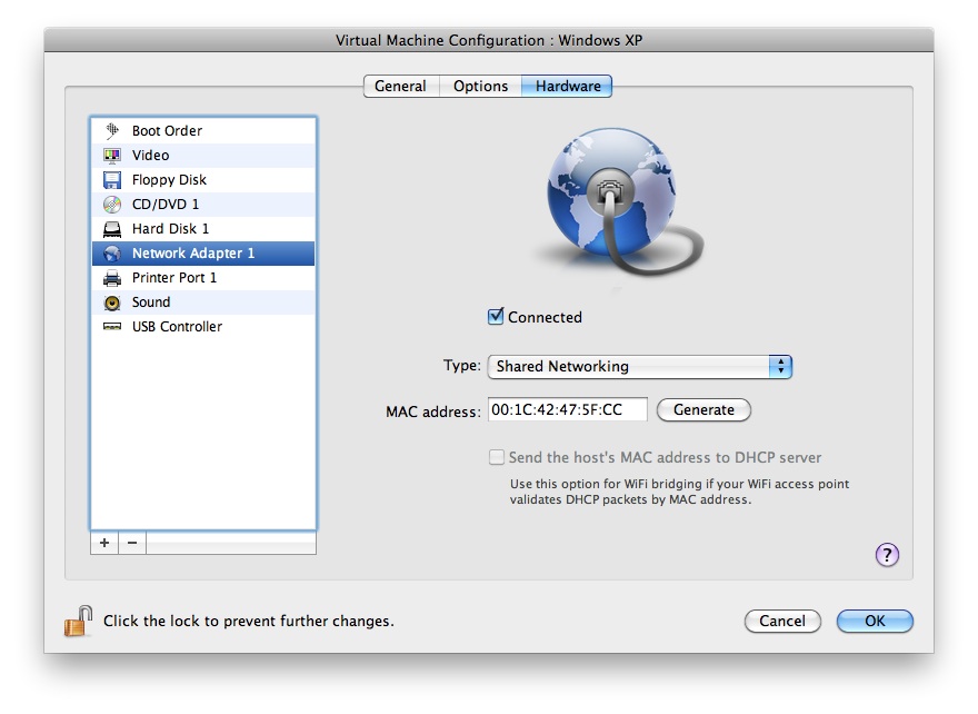

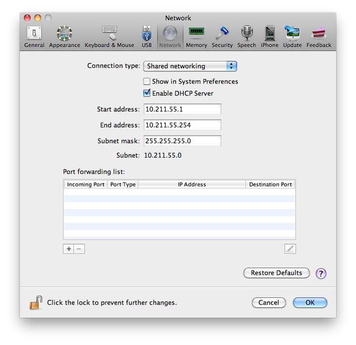

Take a look at these screenshots... do they look familiar?
I am currently online using Airport on Mac OS X; when I try do go online from inside Parallels I get a message that I am not connected.
Both screenshots you refer to are all too familiar. The first looks exactly the same on my computer, IP addresses and all. The second also looks the same, but with a different MAC address and with all buttons/menus greyed out.
