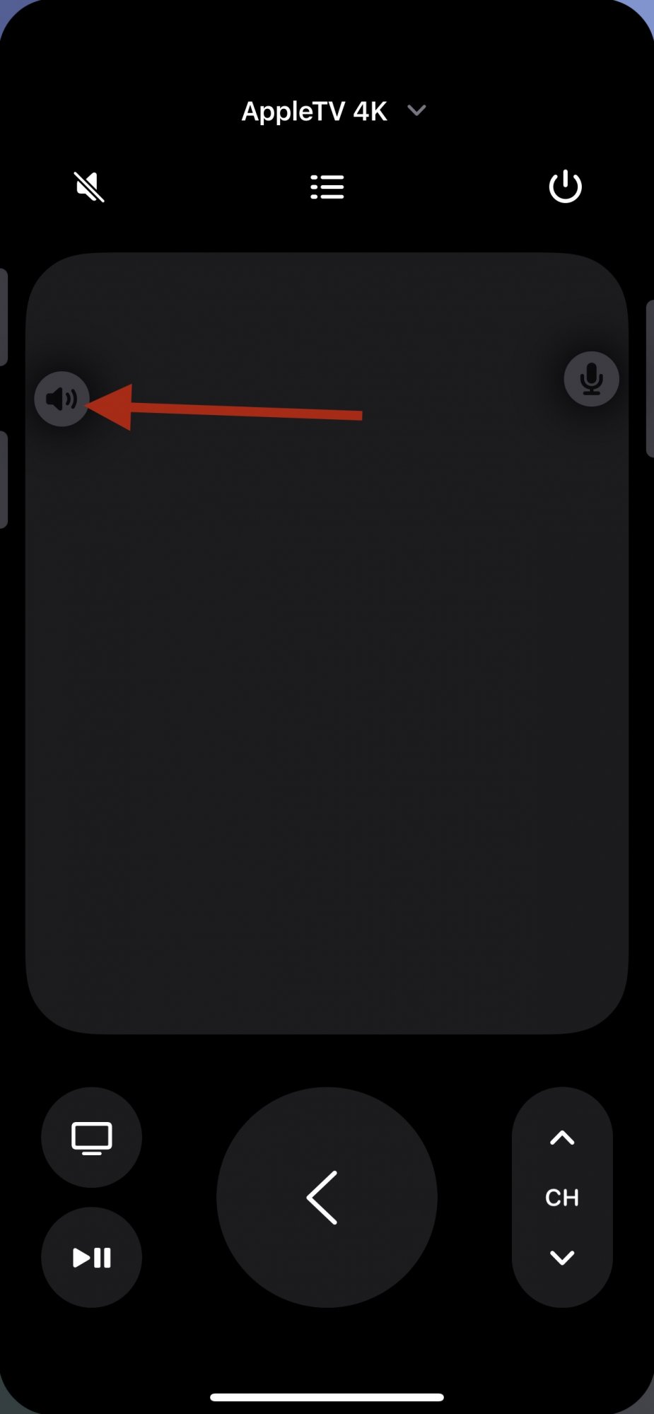

Its a bit of an odd hand off how these apps dont work together. Swipe down on control center and open the remote app. Select the correct AppleTV, the volume buttons should work on the side of your phone the emulated remote.

if the aTV is able to control the volume of the speaker, then you have volume controls in the remote app.
for the aTV to be able to control the volume of the speaker, it needs to have CEC control of your TV/receiver/soundbar, or be using bluetooth or airplay.
if you're using IR to control volume, then volume isn't available in the phone app, since the aTV box isn't able to control the volume. (technically it's the siri remote sending the commands, and not the aTV) they probably could have enabled it to work, but it would be problematic, since if you left the remote facing away from the TV, it wouldn't work.
or in your case, since you're using the 3.5mm port, there's no way to send volume commands to the speakers.
the reason you have a difference between airplaying to the TV, or airplaying to the aTV is due to the same issue.
When you're airplaying to the TV, you have volume control, since the TV is able to control it's own volume.
when you're airplaying to the aTV, you don't have control, since the aTV isn't able to control the volume of the TV, unless it has CEC.
Your model of TV might support CEC, but a lot of times it's disabled by default, enabling it should give you volume controls in the phone app.
