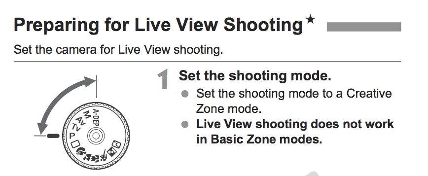

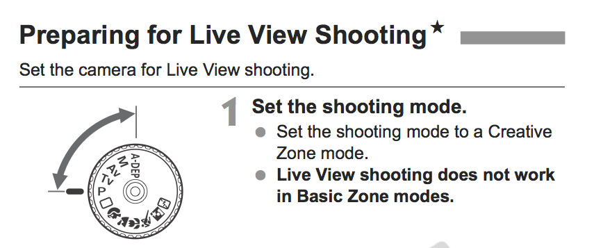

okay thanks os much-can I use LiveView in automode?I read the manual and I thought you could use it in automode if you wanted to..but thanks for the simple solution to what I should have been able to figure out😉

Okay thanks so much for something i should have been able to figure out,the booklet is not exactly the easiest to understand. Can i use LiveView in full auto mode?I read two different thins about this in the booklet?🙄
No I think not:

Well thanks so mu😀ch Apple-I didi go back to the cmera store today and they said in P mode it will work also.So that about answers it for me-thanks so much!!

Also, Live View will work in any mode indicated by an alphabet rather than a caricature.
