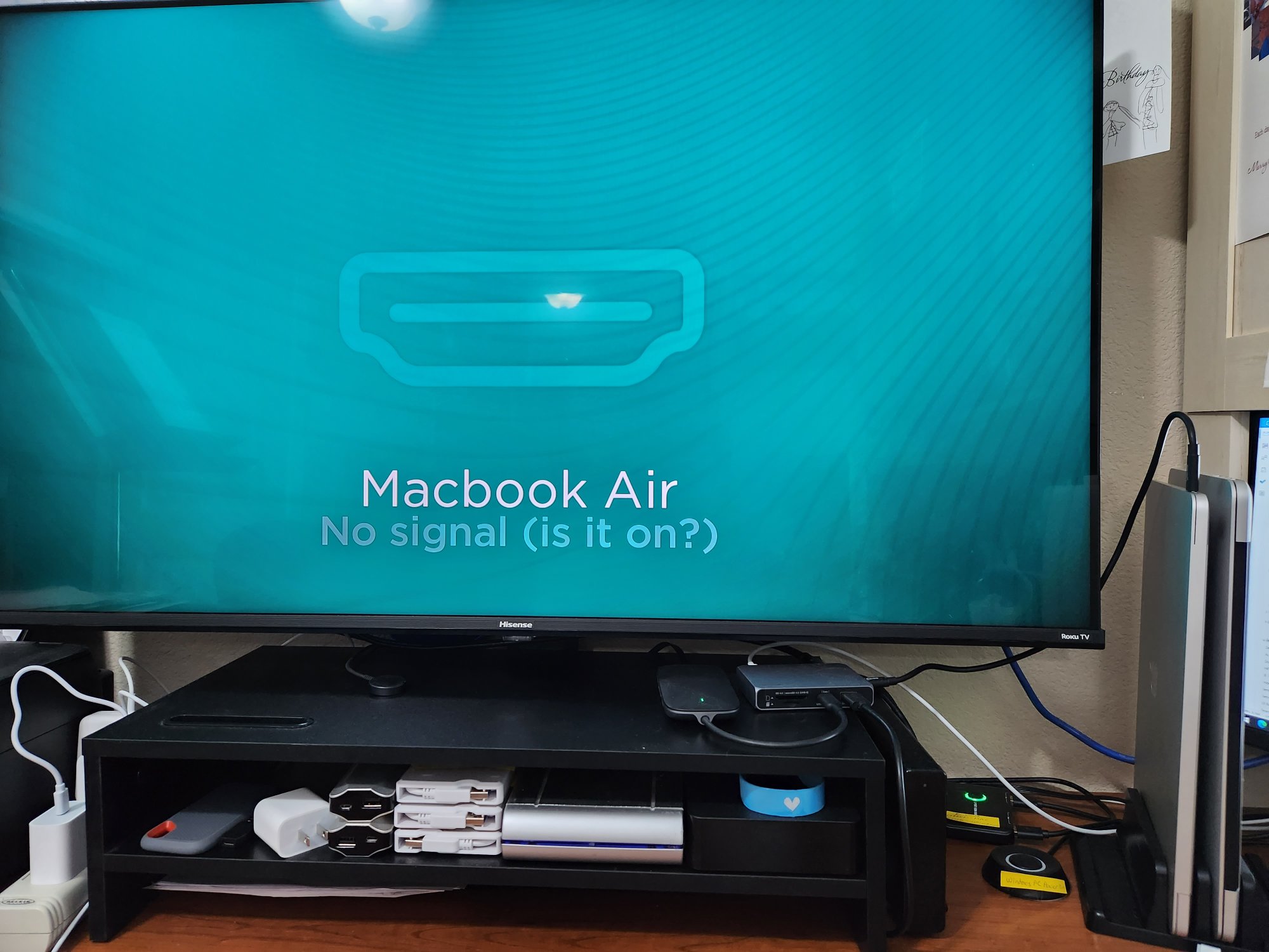

I use a CalDigit SOHO dock to connect my M1 MBA to a 43" 4K TV. This gets around the one external monitor limit, and is also a cheap equivalent to four 21.5" 1080 monitors. Easy dock and undock with a single USBc cable.
The M1 MBA has been great for the past 2.5 years but I want to upgrade to a Max chip and undecided between a Mac Studio desktop or MacBook Pro 14 or 16. I don't really need another laptop though. Being able to take it on the go would be nice but I work from home now and don't need the portability factor as much anymore.
Do you not risk burn in using a tv as opposed to dedicated monitor? Ive just started researching but there always seem to be negatives
Burn-in is a potential risk for plasma and OLED TVs. LCDs do not suffer from burn-in. I've used the 4K LCD TV as a monitor for almost a year now. No image retention issues at all, not that I was concerned about it in the first place. The TV is LCD, just like a monitor or the display on a MacBook or past iPads/iPhones.
