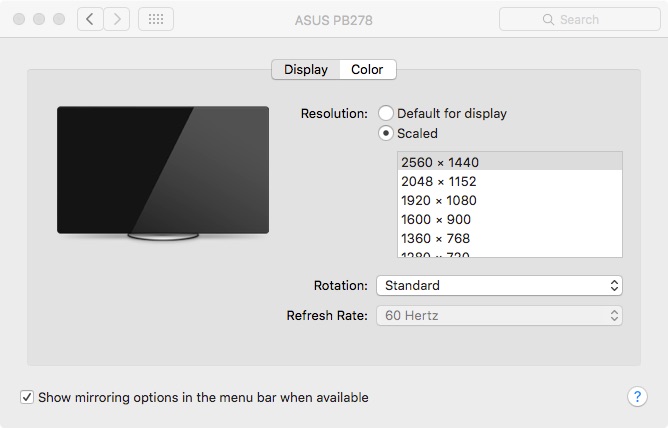

It was a little misleading because you didn't mention that you want to use it in clamshell mode ;D
Can't you change the resolution in the system preferences under "Displays"? In the standard setting, your desktop is mirrored on the external display, which is why the highest resolution, that's supported by both displays, is automatically chosen.
When I plug in my TV, my internal rMBP screen turns the resolution down to 1080p for example, because that's the maximum my TV can display. It's the other way around for you, because your external monitor has a much higher resolution than the internal one. But you should be able to change it in the settings..
I've attached a screen grab of my "Display" settings. My external monitor is already at the highest resolution. Did I understand you correctly... you suggested I increase the resolution of the external monitor?
