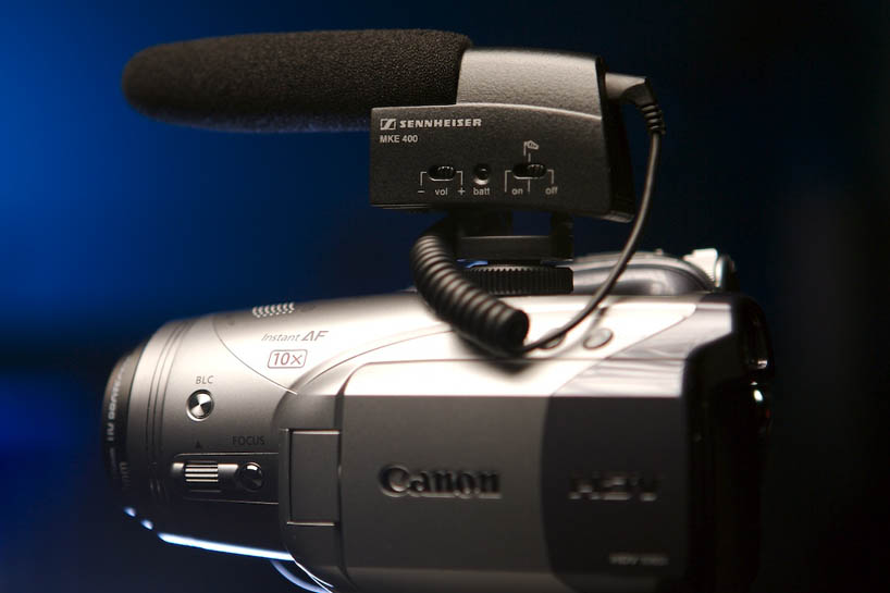

Well the best mic for you would be a shotgun mic. Then you can buy a windsock and slip the mic into it and avoid wind sound.
http://www.creativevideo.co.uk/public/view_item_cat.php?catalogue_number=sennheiser_mke400
this would be the best for you if you want to do home videos and get great sound quality. I bought two of these to try them out and they are great for home videos. This miniature shotgun mic are great, cause they mound on top of your camera and you don't have to hold them. It comes with a wind sock, and what i also like it that you can adjust the mic volume right on the mic.
this is how it looks like on a camera
Hope this helps
Hope this helps
-Bki
This looks like a nice. I'm actually thinking of getting an HV20 or HV30 soon to replace my HC1 which was damaged in a fire (ideally, i'd like a consumer cam that can record to tape and some other flash or hard drive format, but don't think that exists). The only thing I wonder about is wouldn't a stereo mic be better to capture more of everything around you? A shotgun mic would be for getting only what's in front of you, right?
