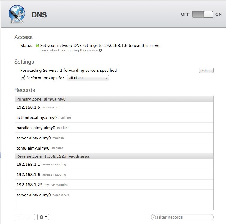

The .local domain is used by Bonjour. Create a unique domain name.
Here is a very thorough guide to Server: http://krypted.com/guides/mavericks-server/.
You will need to set up the DNS server and make up your own TLD so it doesn't conflict. I used to know of a really good guide for this but I can't find it now. EDIT- I found it. http://labs.hoffmanlabs.com/node/1436
Anyway:
1. Give the server a static IP address. You will either have to configure your existing DHCP server (typically your router) to have a range for static IPs or will need turn that off and run a DHCP server on your mini. The mini needs to be configured so that the DNS server it uses is itself (System Preferences => Network => Advanced => DNS).
2. In the DNS server you need to add your TLD as a new zone and your server's static IP as the name server for that domain, and add any systems you want to access with static IPs (including the server itself). I've added my stationary iMac, the router, and a Windows VM I run on the server.
3. In Forwarding Servers, add the name server hosted by your ISP or a public server(s). I use the Google DNS servers 8.8.4.4 and 8.8.8.8.
When you are ready to set up VPN you will need to open up the appropriate ports though your router and probably sign up for a DDNS service so you can access your LAN from the outside world. Note that your TLD you made up is useless outside your LAN (or Virtual LAN with VPN running).

Thank you for the info and the links to the websites. I'll take some time and read through that information.
Currently I've been using my Time Machine for routing and DHCP
Already have a static IP address for my server and a couple of other workstations. And I've also reserve a range of static IP addresses so that they won't be handed out.
Browsing through the link you provided for Hoffman labs it appears I'll have to put a little more thought into the domain name and TLD that I use. I noticed the author recommends to not use .private which surprised me since everything I had come across suggested that if I planned to access the server from outside my local network and did not already have a public domain name.
Would it be easier to just register a domain name to avoid any conflicts? Or is that really not needed since I have no plans to make the server available to the public?
Thanks for the example image that you posted. That will help when I start setting all this up.
Don't be surprised if I have more questions 🙂
Jon...
