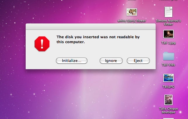

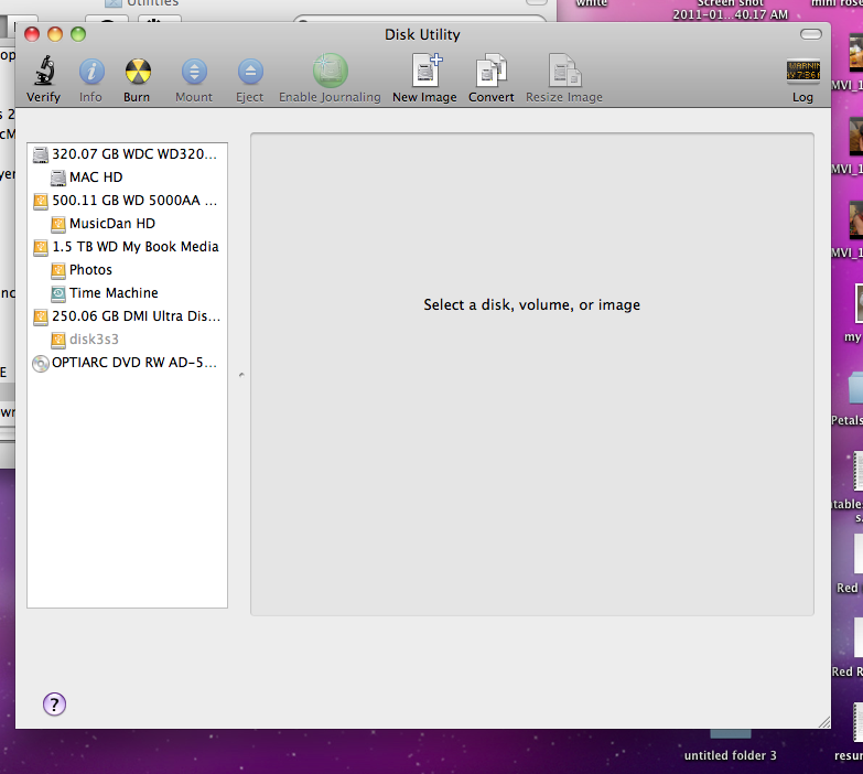

I have an old PowerBook from which I removed the HD. I need to access the information that's in it, my PB died. I got an enclosure for it, plugged it in to my MacBook and iMac but it won't show up. If I go to disk utilities it is present. What can I do to get my files?

If I press initialize, will it wipe the drive?

From your screenshot it looks like the hard drive itself is mounting but the disk3s3 partition isn't mounting. If you select the disk3s3 partition, can you then click the Mount button at the top? Can you select the hard drive itself and run Repair Disk on it?
Can you try the external with another Mac? It's also possible that the enclosure or the cable could be defective.
As to your question, yes, initializing a hard drive erases and formats it, so only do it if you don't care about what's on it.
