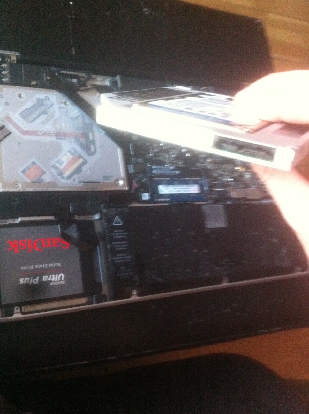

So it looks after I took the case off, the optical out, I received wrong HD case for MBP late 2011?
Am I right 🙁

Thanks man, could you check above image/listing for me, is it wrong?
What about your picture makes you believe that there is something wrong about the caddy?
The only thing that I can see, is that it looks too thick to fit inside the case (and be able to put the cover back in place)
Is that your question?
Other than being a generic item, there's nothing wrong with the listing.
Does the connector from the ribbon cable in your MBPro fit properly in the caddy's connector (the connector in your picture)?
No it fit in perfect..
I thought it would just slide in but i think I might need a cable? You see the slot between my fingers and thumb, what goes in there? Should I have a second cable then yeah? Lie the one connected to the SSD? I don't understand how it connects..
That's a SATA port.
Seeing as your optical drive is still in there, the SATA cable is still attached to it. You'll be able to connect it once you remove the optical drive...
Reactions: Patrick-32
That's a SATA port.
The cable you think is missing is attached to the old optical drive. It's probably still in place.
This iFixit guide should help you. Look at step #16. That's the cable that you need to move from your optical drive to the new drive caddy.
https://www.ifixit.com/Guide/Installing+MacBook+Pro+13-Inch+Unibody+Late+2011+Dual+Hard+Drive/13786
Thanks lads, I appreciate that. I don;t know how I missed it. Thanks again. I'm happy out now 🙂
