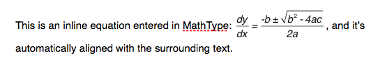

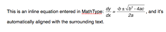

I think you'll find Pages '09 (version 4) + MathType to be the easiest thing to use. Unlike images created in LaTeXiT or Grapher, you don't have to fiddle around with the alignment when you insert something. (So no dragging the image around trying to get it to line up properly with the surrounding text if you insert an equation inline.)
So you can do things like the image shown here pretty easily.
Also, you can match fonts more easily using MathType than you could with LaTeXiT. (Notice that both the equation in this image and the surrounding text are 12 pt Helvetica.)
Anyway, I'd suggest looking at LaTeX (I'm a big fan of TeXShop + BibDesk myself) when you've got the time to learn something new. It's a nice alternative, but both have their strengths and weaknesses.
