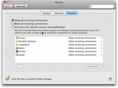

I'm not exactly sure what your settings are, but have you tried to completely allow all incoming connections? If it works after this, you can try to configure it just for the RDC application. You can access your firewall settings through Security in the System Preferences.
Unfortunately, I wasn't able to do any tests with this scenario yesterday. As soon as I can, I'll post my results. In the meantime, I hope this is helpful.
