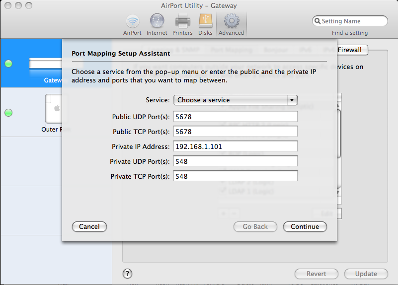

I can't seem to get this to work with my Airport Extreme. Has anyone been successful with changing Port 548 on the Extreme? If so, I would love some help.

The AEBS is actually what I use... here's a screenshot of where you need to make the change. The "5678" is the port number you want to use (but use any number you like, I recommend between 1000 and 9999), and the "192.168.1.101" address should be your server's internal IP address.
