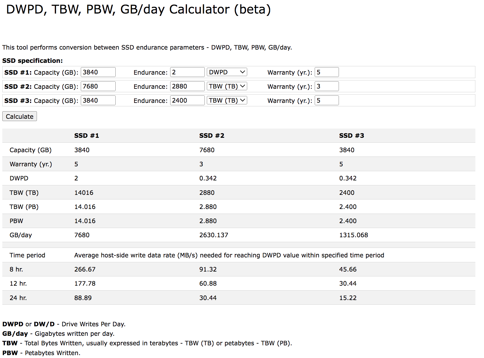

I don't know much about SSD endurance, but I compared:
#1 Intel D3-S4510 (2 DWPD ~= 14016 TBW for 4TB)
#2 Samsung 870 QVO (2880 TBW for 8TB),
#3 Samsung 870 EVO (2400 TBW for 4TB)
with https://wintelguy.com/dwpd-tbw-gbday-calc.pl and while the Intel is better, it is less than an order of magnitude better.
I was expecting something in the one or two orders of magnitude better (10x or 100x), then again, I don't know much about SSD endurance.
Also, it seems the EVO vs the QVO have similar endurance, or did I miss something ?
